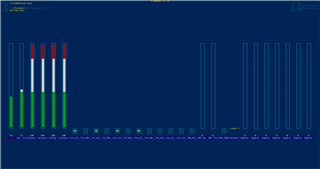

Alsa see the card and working with TVL320ADC5140, including changing value in  corresponding registers. Interested fact that in bookworm 6.12.20+rpt-rpi-2712  no  asound.conf and asoundrc files on corresponding folders.

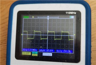

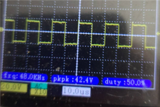

# Clocking (Master Mode, 12.288 MHz MCLK)
i2c_write 0x00 0x13 0x81 # BCLK, WCLK master B1 c1 81
i2c_write 0x00 0x14 0x42 # 48 kHz, 16bit

here is registry dump file 1) after scritp apply, during arecord command, after stop recording. Some registry changing value. For example reg 75 changing value  C0---60---00

  • Hi.
    Some update. Somehow i switched on second channel
    i save config for all files for this case. if there is need i can show changes
    Yes what changes did you make? Is this 2 channels simultaneously? Are you able to use 4 channels yet?
    -Mir
  • i lost this config(. what is done is total  working config  for RP4 for 2channels. i will try to move this config to rp5,
