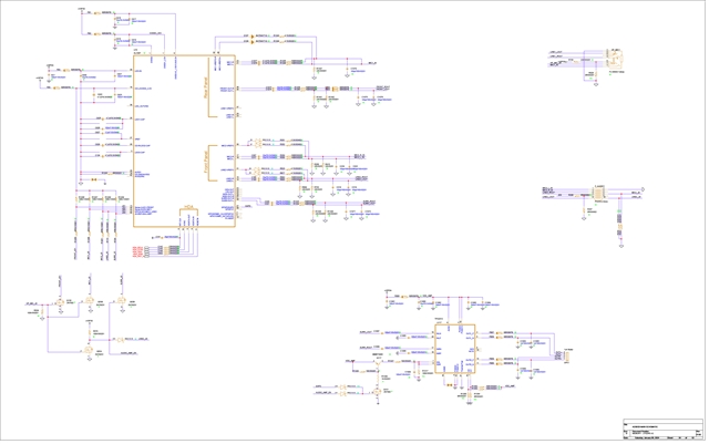

  • Hi Ore,
    Please see schematic ,It works fine on Windows, but there is no sound on Ubuntu 24.04.TPA2012D2RTJR No sound schematic.

  • Hey Rong,
    Here are my comments:
    • Understand that SDR,SDL are active low pins. If 0.35V is on these pins, device is in SD mode.

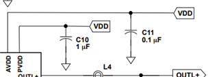

    • if PVDD and AVDD are shorted they could share a single pair of 0.1uF and 1uF or both could be separate lines with the same voltage where PVDD takes the higher cap value for decoupling.
    • The UG has a perfect example for both schematic and component values to pick.... you could implement those values and configurations.
    • Pick ferrite beads or inductors with saturation currents close to the Idd of the IC and output current of the IC. Idd is stated in the DS as 4mA to 9mA with no output filter. The output current could be derived from using this following formula and method
      • P=(Vrms)^2 / R . derive R and Vrms from here
      • Vrms=IR should determine the Iout for TPA2012.
    • Based on the 120KOhm selection on the gain pins, you can use V=IR (V between 2.5V to 5.5V and R=120KOhm) to determine the current rating on these pins for safe current operation of those pins. Right now your resistor is lower in impedance.

    pvdd and Avdd pair from ds:
    pvdd and avdd separation from evm:

    TI: isnt responsible for customer design. Design choices are up to customer to make.
  • After testing, it is not related to the line; it is still a driver issue. It is normal in Windows 10, but the SPK device cannot be found in Ubuntu. Could you please help check what the problem is? Thank you.
