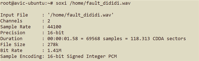

    The audio file we need to play is a fixed file. By using the soxi command to check the file's properties, we confirmed that it is 16-bit, has a sampling rate of 44100Hz, and has 2 channels. When we use the aplay command, we do not specify the sampling rate; instead, the system automatically identifies it. Should this not cause any additional issues?

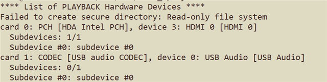

    Can you run aplay -f S16_LE -r 44100 ?
    Also, can you run aplay -l to list the hardware devices? Let's make sure it is being identified correctly.
    Mir

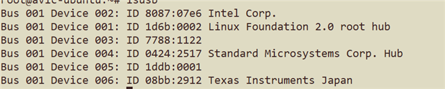

    The application is developed by the client themselves, and the command they use is: aplay /path/file.wav. It would be quite troublesome to replace it with aplay -f S16_LE -r 44100! Below are the output information of the commands aplay -l and lsusb.

    I was suggesting these changes in case it is a power issue - sometimes if there is a spike or dip in the power supply then there may be an issue with the chip, so I was suggesting decoupling capacitor changes for this. But, after some further research, I found maybe there there is an issue with the default card when you are having this issue - was the screenshot of aplay from when the device is erroring when you try to play? If the HDMI audio card, or any other connection to the Linux system with audio, becomes card 0, then it will have priority and maybe it will try to play on that card. When the issue is happening, can you specify which card is being used, and what cards are available on the computer? Check this post for some tips: https://askubuntu.com/questions/638978/unable-to-install-hw-params-usb-xmos-and-alsa
    Mir

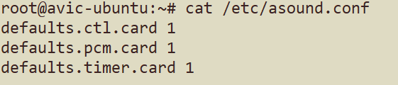

    On my device, there are indeed two sound card devices. One is card 0: HDA Intel PCH, and the other is card 1: USB audio CODEC. To ensure that the system always uses card 1 for audio playback, I added an asound.conf configuration file. The contents of this file are as follows:
    When the issue first occurred, I checked the sound card devices using the aplay -l command and found no abnormalities.
