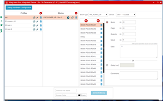

I am working on a custom board running the AM625 and the TAS5802. The integration details can be found on this TI E2E thread.
Currently the amplifier is being detected by the system and ALSA does report its matching playback interface.
The issue I am facing is that the amplifier doesn't enter PLAY mode when I play through it.
After being positive that the McASP was outputting the correct audio frames I focused on the TAS5802 and used the debugging instructions to fetch its regdump:

Inspecting the regdump with the TAS5802 datasheet I see that STATE_CTL from DEVICE_CTRL2 register (3h) is set to Hi-Z
I tried manually setting it to PLAY with:
echo 0 0x00 0x00 0x03 0x03 > reg
And immediately the amplifier started to drive the speakers.
This is the output from the driver, just in case it is relevant:
[ 1174.561113] tasdevice-codec 3-0054: tasdevice_hw_params: Playback
[ 1174.569234] tasdevice-codec 3-0054: tasdevice_hw_params: BCLK rate = 1536000 Channel = 2 Sample rate = 48000 slot width = 16
[ 1174.608625] tasdevice-codec 3-0054: powercontrol_routine:1276: enter
[ 1174.615036] tasdevice-codec 3-0054: select_cfg_blk: profile_conf_id = 0
[ 1174.621664] tasdevice-codec 3-0054: select_cfg_blk: conf 0, block type:PRE_POWER_UP   device idx = 0x00
[ 1174.640313] tasdevice-codec 3-0054: powercontrol_routine:1285: leave
I am unable to attach the .bin file on thie thread. If you'd like to inspect it please message me and I can share a link or send it directly over email. FWIW, it was generated from tas5802-1amp-reg.json from the same repo as the driver using the instructions.
My expectation is to have the amplifier playing without me poking its registers. Any thoughts on what may cause this?
