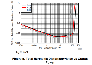

    Q3
    you can refer this similar plot for reference.

    Q3. the plot should be what you want. can you share me what kind of plot and let me see whether i can provide that.
