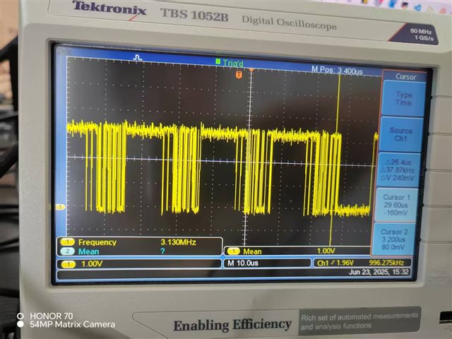

    Can you explain your issue more? You are able to get output but the frequency is too high? What files are you trying to play? Can you make sure that the files you are playing are at the appropriate sample rate? I see that your mclk-fs is 384, so your MCLK=384*samplerate, but what MCLK are you providing? I hope we can figure out your issue.
    Mir
  • Yes, I could see the output on LINE OUT, but the frequency is too high, more than 1MHZ.  It seems the output is just some noise. I played a two-channel 440 Hz sine wave audio which is generated by audacity,sample rate is 44100. The Mclk is 384*44100=16934400HZ.  Is it normal that I play mute wav file, but the output  is a sine wave with relatively stable frequency of 1.18MHZ and amplitude? I could see all zero on DIN line when I play the mute file.
    I Try to simplify things a bit with using only one of the 4 codecs like 0x18 and let it to be the master and cpu to be the slave. The result is the same as that of tdm setting.
    Any output from the DAC you see over 22kHz is going to be noise - maybe the 1.18MHz you are seeing is some factor of the internal modulator or something internal to the processor coupling into your scope lines. The DAC should have an output interpolation filter at 0.45*fs. Can you give me a register dump of the device to check the output and clocking settings? Are you providing BCLK and WCLK, or just MCLK? In your DTS file, it says your cpu is the master so it is generating BCLK and WCLK as well - are you able to measure those on a scope to check the frequency, making sure it is 44.1kHz on the WCLK and 8.4672MHz BCLK?

  •  FCLK   MCLK   BCLK   I find it is a little different from the exact value I set. I use the audio reference clock for mclk and the parent is <&k3_clks 157 7>;  Maybe I should use one of the codec as master. But I think it is not the reason that the output is noise.
    Looks like your register 0x5e (register 94) is set to 00 so all outputs and L/R DAC are powered down - can you adjust your amixer settings to turn on the DAC and line outs to ensure that your issue is not this. Also, can you attach a schematic of your connections? What happens when you aplay a sine wave, and can you attach your reg dump during playback?
    One more thing is that your clocks look like they are not providing a stable output level - and are around 3.3V, are you using a 3.3V IOVDD or 1.8V? The ASI clocks should be at the same level as IOVDD. I wonder if one of these problems is causing your output issue.

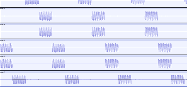

  • Hi, playback is normal now. However  when I use arecord to capture a sine wave audio source, I capture all zero in my wav file. I mesure the input on LINE2L, it is a correct sine wave  with zero DC offset, oscillating symmetrically around 0V. I could see the signal change on mcasp rx line, but the voltage is not very correct, it should be 3.3V but actually it is 2.6V. Below are the codec register I dump during the capture process.
    arecord -D hw:0,0 -f S16_LE -c 8 -r 48000 output.wav
    Register 36 is all zero, but I have already set register 22 and register 19 to power on ADC

    There is another thing confusing, When there are only channel 1 and channel 2 having audio signal input, if I record 8 channels, then the audio data recorded is evenly distributed across 8 channels(I attach the screenshot on audacity tool). If I record only 2 channels, the saved data is normal. How should I modify this to let data only appear on the first two channels? attached is the recorded audio data for 8 and 2 channels.
    If you switch to regular I2S mode instead of 256-TDM, that should help with only outputting stereo. You should still be able to use a 256*WCLK as your BCLK, just there will be some cycles unused. Do you mean to be inputting 8 channels of TDM and only output on the first two? If so, I can look more into the reg map and help you out there, tomorrow.
    Mir
  • I have configured 8 TDM channels in the device tree. During my test, only the first two physical Line2 IN inputs actually have analog audio signals connected. The remaining 6 channels have no valid analog input.
    When I run the following recording commands:
    arecord -D hw:0,0 -f S32_LE -c 2 -r 48000 output.wav
    The recorded data is correct for both channels.
    But when I run:
    arecord -D hw:0,0 -f S32_LE -c 8 -r 48000 output.wav
    The recorded data is not as expected.
    I expect:
    • The first two channels to contain valid audio data
    • The remaining six channels to be filled with zeros
    But in reality:
    • All 8 channels contain data, and the invalid channels seem to have duplicated or unexpected content
    • It appears that the valid data from the first two channels gets redistributed or repeated across the 8 output channels
    I would like to know:
     White check mark How can I ensure the invalid channels are filled with zeros as expected?
     White check mark Is this caused by ALSA behavior, driver configuration, or hardware settings?

  • After I add -period-size=8 parameter to arecord -D hw:0,0 -f S16_LE -c 8 -r 48000 -d 10 output.wav --period-size=8, I could solve the problem that audio data of 2 channels being distributed to other 6 channels.
    I have measured the clocks and data when I record with 2 vs 8 channels, there is no difference. I think the driver do the things that mask invalid data in the slot and then send the data to alsa.
    I also found the root cause that make me unable to record audio before. It is the pin mux, I set the RX pin of mcasp as output in devicetree.  But I do not know why the output setting causes the mcasp controller unable to get the data.
    When I used the cpu as master, I also changed the audio refrence clock's parent so that it use the same parent as mcasp IO's.
    I tried to set different slot size during debug, so when the offset is 96, I think the slot size if maybe 24/16.
