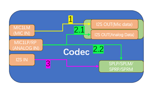

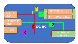

I want to use TLV320AIC3111 to achieve audio flow below:
As I confirmed with datasheet, It should be OK.
But I have some question to confirm:
1. I think flow 1 &3 can use MIniDSP, but can flow 2.2 use MiniDSP too? If not, Do TI have any codec support this?
2. Flow 2.1(analog in to i2s out) should be mono for TLV320AIC3111. If I want to stereo, can TLV320AIC3254 + AMP achieve same flow(1+2.1+2.2+3)?
3. It will be better flow1 flow2.1 flow2.2 flow3 can use MiniDSP and flow1 flow2.1 flow2.2 flow3 is stereo, Do TI have any codec support this?
I use one cell battery(4.2V max) for my system and it will better that battery connect to codec directly.
    You should not need miniDSP for any of your flows here. Our codecs typically work by converting analog audio in to I2S out and I2S in to analog out - this device has an integrated speaker driver so you can do I2S in to speaker out. This codec also has a path to send mic input directly to the speaker or headphone out mixes, this is called an analog bypass because it bypasses the ADC/DAC and sends the analog input directly to an analog output with no digital conversion. You would only use miniDSP to integrate effects and real time DSP you needed on the digital audio, or if you wanted to do a digital bypass (I2S in to I2S out, without using direct wire connections to do this). So, to configure your different flows, you can do I2C writes. I would recommend that you use the SLAC289 EVM software https://www.ti.com/tool/download/SLAC289 to configure and write the I2C for you, or check the datasheet. The speaker driver on the AIC3111 is stereo, so your flow 3 will work in stereo as well.

  • Hi :
    I will use DCDC to generate 3.3V(MCU and other peripheral devices will use this too) and LDO for 1.8V, is it OK?
    I need MIniDSP to calculate input level(for lighting) and make PEQ for both I2S in and analog in. Also, I need detect environmental noise, that is why I need flow1 flow2.2 flow3 can use MiniDSP, so do you mean flow2.2 can't use MiniDSP?

  • Hi :
    We don't want to use AIC3262, AIC3263 because of the BGA package.
    So do you mean flow2.2 can use MiniDSP with AIC3254/3268 while AIC3111 can't?
    If so, which input and output should I use in PurePath Studio for flow2.2?

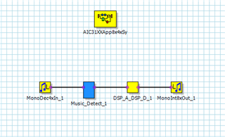

    I think the AIC3111 should be able to use MiniDSP - you got it working already, right? The issue was that it only supports mono ADC. But it does have a stereo speaker output. The AIC3254 does not have a speaker amplifier so you would need to connect the line outputs to another amplifier. The flow would look like this in PPS:
    However, keep in mind that this is how a normal DAC output would work, so unless you are using any other DSP algorithms, I would recommend not using PPS and just writing the registers for DAC operation. This would be easier for your config.
    Mir
  • Hi :
    I know MIC1LM to I2S OUT can use MiniDSP, I2S IN to SPLP/SPLM/SPRP/SPRM can also use MiniDSP.
    But what about MIC1LP/RP to SPLP/SPLM/SPRP/SPRM?
    Can this use MiniDSP too?

  • Hi :

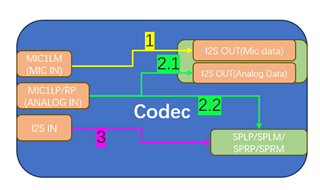

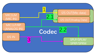

    I think the flow you give should be MIC IN to SPLP/SPLM/SPRP/SPRM(red line(4) below):
    So do you mean flow 2.2 can only use analog bypass? Which means  PPS modules are not available?
  • Hi Zhou,
    Mir is out of office so I will help here briefly,
    I agree with his flow. He is disregarding the analog bypass as it was a misunderstanding. The flow does not use analog bypass.

  • Hi :
    Have you returned to the office?
    Can you help confirm my question?
    Yes, the red line would be what my PPS screenshot was, flows 1, 2.1, 2.2, and 3 will not need PPS since they are standard ways that the ADC and DAC work. If you want to use any digital effects or analysis with PPS, you can, and yes it would be as you expect. You can use 2.2 with PPS with digital blocks, as shown here:

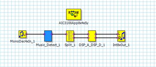

    The AIC3111 only has one ADC, so it can only do mono input. It can do stereo output if that is desired, just choose "Int8xOut" instead of the mono output, and use a splitter as shown:
    You do have to configure the inputs in SystemSettingsCode (where you put the I2C commands for the device) in PPS, because yes the "Dec In" or "Int Out" blocks are for the ADC and DAC so that is internal to the device. I2C is used to route the input pins to the ADC, and DAC to the output pins on the device.

    I think the flow you provide is 2 mono output, not stereo output, is that right?
    And does TI have any codec that can support analog in and mic in use PPS at same time? I want to detect music in analog in and record data in mic in.
    Since the input is only able to be mono, then yes the output there is just a doubled version of the input. The AIC3111 only has one ADC so it could only process one input stream at a time. We had discussed the AIC3254 earlier, it has stereo input with 2 ADCs that could process different signals at the same time, but note that it does not have a built in speaker amplifier so you would need another amp chip like the TPA2011 or something similar if you still also need to drive a speaker (with higher wattage than the headphone output would allow).

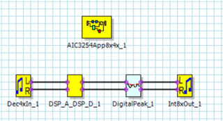

    You could do something like this screenshot as an example, it would do music detect on only the left input ADC and then pass the right one directly to I2S out which could be used for recording in your MCU or computer.

  • Hi :
    I think Dec4xIn_1 can only be either analog in or mic in, right?
    The Dec4xIn is the ADC block, so the left outlet is the output of the left ADC, and the right outlet is the output of the right ADC, as shown here in the block diagram of the AIC3254:
    So, you can choose what goes into the left and right ADC, these go through a PGA (programmable gain amplifier) which is the triangle you see before the ADC blocks. You could have a mic in to the left ADC and a line input into the right ADC, for example. Then you can process the left and right signals separately in PPS.
