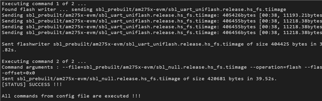

Hi all,
I'm following the steps to setup AM275 EVM board as per - https://software-dl.ti.com/mcu-plus-sdk/esd/AM275X/11_00_00_16/exports/docs/api_guide_am275x/EVM_SETUP_PAGE.html
Able to observe prints on UART mode:
And I've able to flash: sbl_prebuilt/am275x-evm/sbl_null_hs_fs.cfg as below:
But after changing to OSPI_NOR mode, connecting to Serial console and power restarting the board: there are no UART messages from XDS110/User UART as mentioned in documentation.

  • Sorry its working fine I was not checking right com port i.e. WKUP R5 UART console, so probably you might need to update the documentation on which UART to check during UART mode (UART boot com port) and OSPI mode (WKUP R5 com port).
