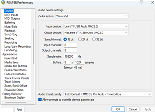

In the windows driver, I choose "8 channel, 16 bit, 192000 Hz".
When I press read in the Clock Monitor, the BCLK/FSYNC ratio is automatically configured to 64 which should allow for 4 channels of 16 bit word length.

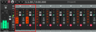

I am using Reaper (DAW) to analyze the input from each channel and I can only see output on 2 channels which is mic 1 and 3.

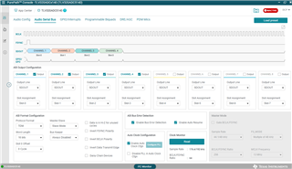

Furthermore, I've tried to debug the signals BCLK, FSYNC and SDOUT where I've marked each distinct audio stream (red, blue, green, yellow):
I've checked that these are in fact the audio streams for channel 1,2,3 and 4 by disabling them individually and seeing that the audio stream disappears for that slot.
The blue and yellow audio stream (mic 2 and 4 mapped to slot 1 and 3) gets ignored completely and I can only see the audio from mic 1 and 3 which are mapped to slot 0 and 2.
Furthermore, the FSYNC signal is described as being a pulse, but here it has a 50% duty cycle which is a discrepancy according to the TDM format described in this video by TI: https://www.ti.com/video/6311104210112
I've noticed that the 50% duty cycle for FSYNC only appears at frequencies above 48kHz for some reason and as a pulse @ 48 kHz and below
which is also where FSYNC/BCLK ratio changes from 256 (<= 48kHz) to 64 (> 48kHz).
I have tried to do the same setup (4 channels @ 48 kHz, 16 bit word) where FSYNC/BCLK ratio is 256 and I can get 4 distinct audio streams to appear in my DAW but only if I map the channels 1,2,3 and 4 to slot 0,2,4,6.

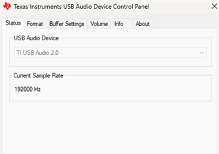

    However, When driving clocks from USB can you double check the TI USB Control panel? Icon should be present in bottom right hand corner for Windows. The sample rate the Audio device is receiving will be verified here as well
    Can you also change the clocks from 8 channels to 4 channels on usb device.
    The 'skipping' during recording is due to a ASI clock format misalignment. TDM mode is very flexible so its allocating audio in the slots it can based on the FSYNC architecture.

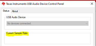

  • Hi Daveon
    I have looked at the "Texas Instruments USB Audio Device Control Panel"to confirm the sample rate and it says 192 kHz as expected
    I do not see the option to change from 8 channels to 4 channels
    My primary purpose for this test is to confirm that the TLV320ADC5140 can in fact support sampling of 4 channels @ 192 kHz, 32 bit word length. Will I need an external ASI to confirm this or is there a work around to test it with the USB bridge?
