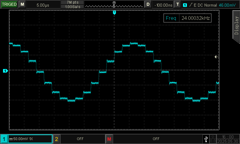

After using two PCM5102A in an audio application for several months working fine both IC changed behaviour concerning oversampling rate. There is no changing in hard- or software after running the application first, all digital signals and all supply voltages are OK. I attach a screenshot of the DAC output signal.
Conditions are: SCK 12.288 MHz, BCK 3.072 MHz (32 bit per channel), LRCK 48 kHz, sine wave of 24 kHz
Without oversampling there should be two square wave pulses per period, one with a positive and one with a negative amplitude. The number of steps here is 16, so it is 8 times oversampling instead of 256. I tested with SCK input grounded, no difference. Digital signals are generated from SPDIF receiver WM8804, left justified PCM, output of DAC is loaded with RC filter (680R + 2.2nF) and the input of a PGA2311 (Rin 10k).
I can exclude an ESD damage. After detecting this error I populated another board, with two new DAC from the same delivery as the both used ones. The oversampling rate is also not correct.
Hope you have an idea where I should pay attention to.

    Sine wave signal levels with data only in the MSB region are valid audio levels and there should be no noticable steps visible with 256 fs oversampling. It should be a sine wave with HF noise at the DAC output and suppressed HF noise behind the RC filter.

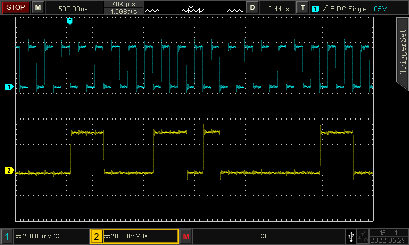

    attached you can find screenshots of the input port. Triggering is caused from rising edge of LR signal, you can see bitclock and data written into the DAC. Hardware setting of PCM5102A is for left justified audio data transmission. Can you see something wrong here? I can't.

    I'm using left justified data format. I could upload the screenshots!
    Explanations to signals in my last message. If you need more/different signal recording for clarification please let me know.

    SPDIF signal generating is accomplished with a PC software and a USB sound module. At a sampling rate of 48kHz and a signal frequency of 24kHz it generates the minimum and maximum peak value of the sine wave (e.g. +32767 and -32767 or smaller), only two samples per period of the sine wave!
    The two screenshots I send to you in the last message are comparable to figure 13 of the PCM5102A data sheet, they show these two values. A negative value (~data1.bmp, first and most significant bit is high) and the positve one (~data2.bmp, first and most significant bit is low). Trigger point is marked with a T and corresponds to the rising edge of the LRCLK. BCK is 3.072MHz, data is output at the falling edge of BCK and valid with the rising edge of BCK (take over the value). Because LRCLK is high the data will be output on the left channel of the DAC.

    I prepared a test circuit for PCM5102A to check with different sample rates of 32kHz and 96kHz, the problem persists. Please find attached the schematic. I add also a screenshot of a signal with 256 times oversampling, the sine wave is the output signal of WM8524 under same conditions as PCM5102A. Please compare the signal with the first screenshot at the beginning of this chat.

    I assume the waveform above ( which is what we expect to get)  is from WM8524 on a different board ( may be similar or even identical layout ) but not the same board that PCM5102A is sitting on it at the moment . So that leaves  the possibility of issue with other components  on the board, not necessarily the DAC itself, and the new samples could confirm that.
    If the new samples work fine on the same old board that was working for a while,  then it confirms it is the DAC's issue ,and if they still  fail on your board, then you should check other components on the board.
