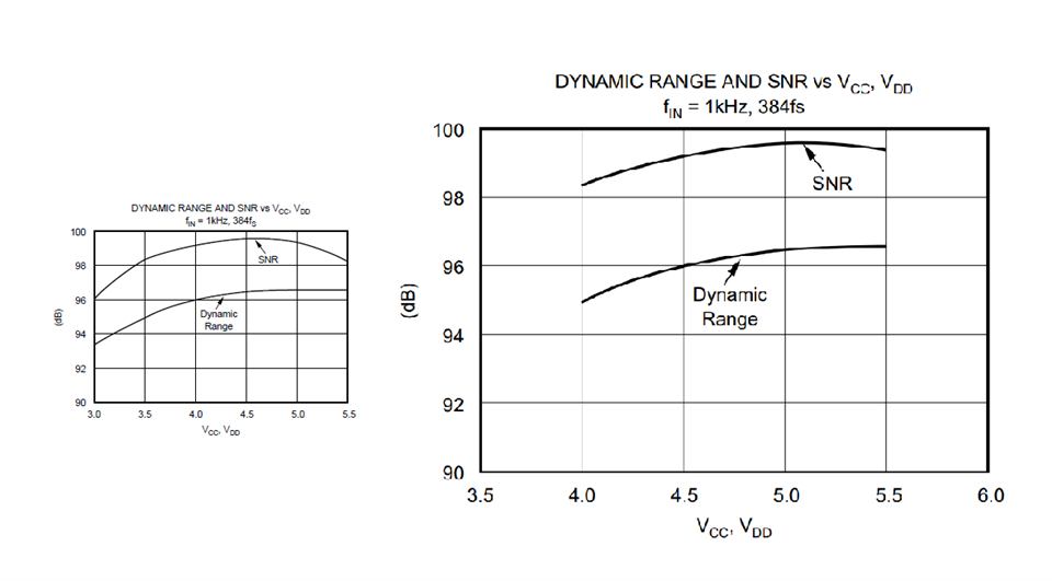

We are working on addressing the Obsolescence in which PCM1717 is obsolete and we are using PCM1718 as a alternate.
The design used for PCM1717 is retained, and same is used for PCM1718. But we see the noise gets increased in the new PCM1718 IC.

    Although the specs tale  in datasheet look identical for both of them , by looking at the dynamic performance plots I can see the performance difference. For example
    The plots of DR and SNR (page 4 in datasheet) @ 4V    for PCM1717  indicate DR=96dB and SNR ~99dB  but for  PCM1718  they are  DR=95dB and SNR ~98.5dB.
    Similar observation holds for THD+N . Note also the range of the plots for PCM1718 is 4V to 5.5V  but PCM1717 is 3.0V-5.5V
    So your observation seems valid. If your applications requires lower noise, we can take a look at other alternatives but for sure you have to change your board layout  as pinouts will be different.
    Arash

    Yes, The Hardware control version of this device (1718) has a limited De-emphasis options:
    As I mentioned above, we do not have a pin to pin compatible device and you have to go with a totally different pinout and even package.
    If you  do not want to go with PCM1718, let me know if you need any help to find a suitable device for your application.
