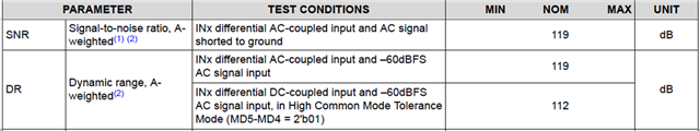

Our customer has a question about single end AC-coupled SNR, DR soecification or characteristics.
As the datasheet specifies SNR, DR in differential AC-coupled input specification.
- Can you let us know SNR, DR in single-end AC-coupled input specification or characteristics.
- Do we understand single-end SNR, DR expects -6db lower than differential spec below.
