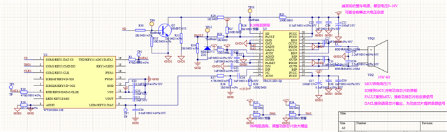

1.Is it okay to design the INP input circuits R37 and R38 in TPA3112D1-Q1 like this? On the left is the voice chip
2.At present, we have found that after disconnecting R37, other signals are supplied normally according to the working mode, but the fault pin reports an error (measured as 0V). Only after re-powering and reconnecting R37 can normal operation be restored. Why is this?

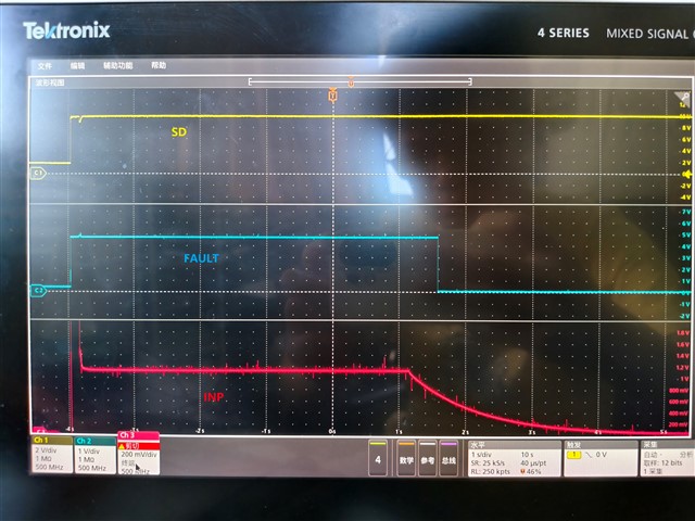

  • After power-on, the fault pins of the product TPA3112D1-Q1 were set low. The captured waveforms and circuit diagrams are as follows
    If SD remains in an invalid state after power-on, the fault pin will not be set low.
    Could you please help analyze what the reason is
  • HI Ian
     The INP voltage drops before FAULT pin, is there any thing on your board would affect the input side? What is R38 value on the board, try remove it. And any possible shortage?

     Please capture the waveform at Pin11 and Pin12 directly, let's see the waveform first, thanks.
  • The figure shows the captured power-on waveform. The voltage difference between INP and INN is approximately 1.2V, which lasts for 6 seconds. The SD enable is turned on, and no FAULT is reported.
  • Hi Ian
    Your waveform, INN is always 0V, is not correct. Device need to setup DC bias voltage at all input pins during power up, otherwise would fail to start up.
    Could you check all the input cap is fine on your board?
  • This is the schematic diagram. Please help review it. My INN is grounded here. How can I apply the bias current.
  • Hi Ian
    Where do you captured the waveform? The position 1 or position 2?
    The bias voltage would be set up at the capacitor C35, if you test at position 1, should able to find it.
  • hi
    You asked me to capture the waveforms of Pin11 and PIN 12. PIN11 is INN. I captured a waveform diagram. You said that the voltage of INN has always been 0V, but INN is grounded. How to apply the bias voltage? I saw that the demo board is also grounded. What's wrong with my understanding?
  • Hi
    The correct Pin11 and Pin12 waveform should be as below, you could see that after power up, IC will charge this 2 pins together, to around 3V. You could test it on the EVM.
    Your side Pin11 is always 0V, and Pin 12 jump to 3V for a moment and quickly pulled low to 1V, and finally shutdown.
    but INN is grounded
    Why INN is grounded. Is C35 on your board or not? As long as C35 is there, the pin 11 is not directly grounded, correct?
