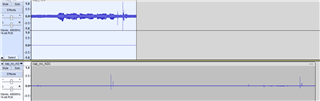

The gain is too low during microphone recording. If there is obvious background noise after turning on AGC.
I would like to ask if there are any other configurations for increasing the microphone gain.
I use the following command to call for microphone recording, and only the AMICL channel is needed.

  • The following are the recording files with AGC enabled and disabled respectively.

  • 1. I modified the value of adc gain (reg: 0x0f) to 75 and turned off AGC. The recording volume has improved, but at the same time, the background noise has also increased.
    2. When this value is increased further, the recording becomes muted.

    I looked at your audio files, and we can see that the AGC boosts the audio by a lot!
    First, see if you can place the microphone closer to the subject you are recording to try to increase the microphone signal to noise ratio. Then, to further increase the gain but try to cut off the noise, you can turn on the AGC, and the AGC has a noise gate setting which if you set the gate at the average dB level that you see is the difference between the signal you want versus the background noise, it will turn off the extra gain on the noise. The settings for that are in registers 26-28 for the left AGC.
    I don't know what you mean by the value increasing mutes the recording - the max PGA gain you can apply is 59.5 dB, and if you set your register to 0x75 then the gain applied is 58.5dB. You can also adjust volume in to the ADC with registers 17-24 for input level control, make sure you are not attenuating the signal before it makes it to the PGA (set to 0dB input level control gain).
