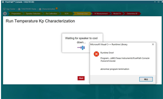

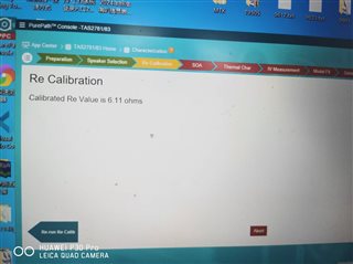

when the process is arrive to thermal char, we always encounter below question,  the IT department also cannot resolve it, so could you tell me how to resolve it ?
  • I have changed my computer and connected to the Internet, and also have tried turn off the IPguard. but this question still exist.

  • Hi Gary,
    Looks like VC++ redistritube is not installed as expected. It will be downloaded and installed as part of ppc3 installation. Maybe there was some issue with the installation. I will send you the vc++ exe via email separately. You can install it separately and retry.

  • I have retry install the vc++.exe, but this problem still exist.
  • Hi Gary,
    Could you please attempt to uninstall PPC3 completely and try a new install?
    do you have a second PC available? can you try on a separate PC?
    Arthur
  • Arthur,
    I've changed another PC from my college, also my personal PC, they all didn't work.
    Also tried uninstall and re-install and run as administrator.
    Result is still same as screenshot at above.
    Gary

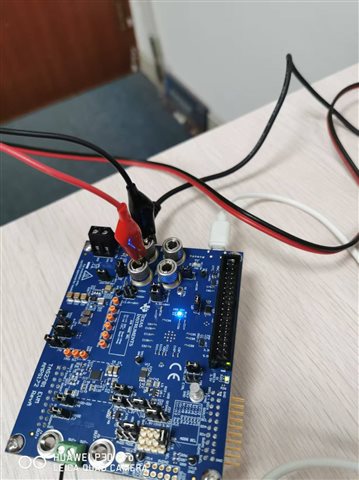

  • Hi Wenbin,
        The EVM board is connect with a speaker.
  • Hi Wenbin,

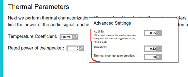

        How to set the Thermal char test tone duration,  if set it to 300s,  this page will black and exit,  but set it to default value10s, it can work normally, I think 10s is too short.
  • Gary,
    for the Kp Char 10s is OK!. this is just the first step in the larger thermal char process. a longer tone will be used later in the characterization process!
    Arthur

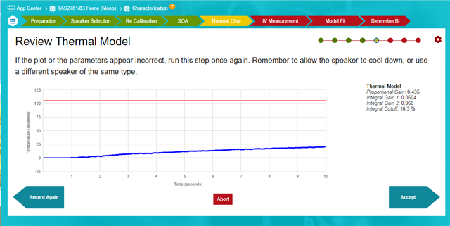

  • Hi Arthur,
         The next step after the Kp char is the thermal mdele, but it also 10s, temperature change is very small.

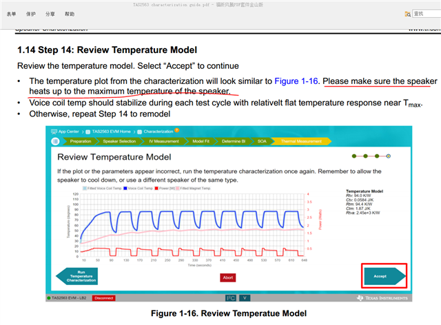

  • Arthur,
        As required by your document,the speaker heats should up to the maximum temperature of the speaker
  • Gary,
    TAS2781 has a new thermal controller and thermal characterization process compared to TAS2563.
    during the thermal characterization process the speaker may not heat all the way to Tmax and it is OK. however, your plot still seems low.
    How are you powering the EVM? what is the PVDDH voltage you are applying to the speaker?
    you may also try increasing the speaker rated power. since it is 10W your speaker may be hard to heat up by TAS2781 if the full 16V device gain is not used. i would suggest you use a PVDDH voltage like 18V connected to banana connectors from a dedicated bench supply
    Arthur

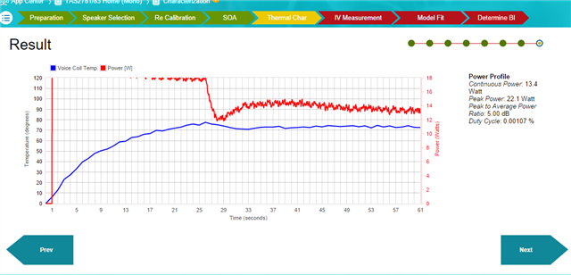

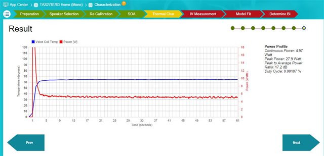

  • Hi  Arthur,
        I connected an external 19V power supply to the PVDDH, the thermal characterization result is shown in the  below image :
    1. I think the Max temperature is still small, even though the power  has reached 15W;
    2. Why is the power abnormally high in the first few seconds?

  • Hi Gary,
    Apologies for the delay as i was out of the office last Friday
    this results you are sharing now look expected - even through it is not reaching to the Tmax during characterization.
    What have you changed? only making PVDDH = 19V?
    have you increased the "rated power" parameter in the Thermal characterization panel? - previously you were entering 10W.
    by increasing this you can cause the thermal characterization to settle at a higher temperature. - this value is only being used by the thermal characterization to determine the signal level to be used. if you increase it the characterization will result in higher thermal controller gains and therefore a higher settled temperature.
    Arthur

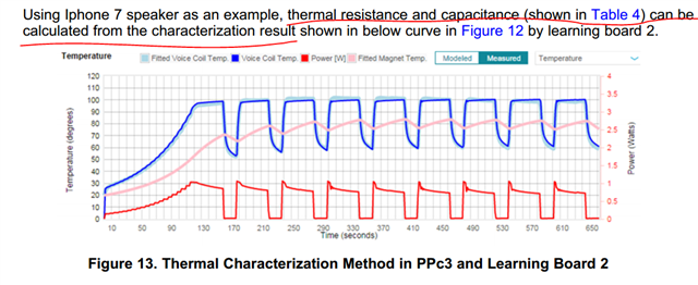

      2.  My results now look expected, does it  mean thermal resistance and capacitance also can be calculated from my above characterization result?

  • Gary,
    Thermal resistance and capacitance are not being used by the new thermal controller in TAS2781 compared to TAS2563.
    The TAS2781 thermal characterization it is not expected that the speaker will reach the Tmax during the thermal characterization process. the thermal char is leaving some margin to give a smooth thermal controller tuning across all types of speakers.
    If you want to make the thermal controller more aggressive you can increase the "rated power" during the characterization process. OR you can fine tune thermal controller gains manually

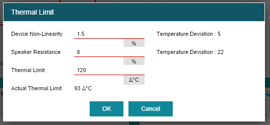

  • Hi Gary. I see the voltage is limited. Can you please provide the PPC3 file to me?
    What is the frequency of the tone?
  • Hi Gary.
    Sorry i see you provided the file.
    I know the issue. you have entered the speaker resistance variance as 6%. this means the algorithm is limiting the speakers temperature to ensure that a worse case speaker (6% lower Re than the nominal value) will not be burnt. the algorithm is limiting the temperature to 93C which is what we see in the temperature plot.
    Can you please set speaker resistance to 0%? this should allow the speaker to heat to 115C.
