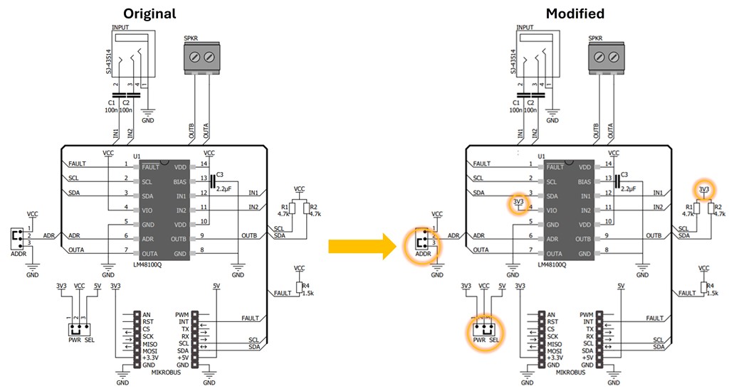

I am using the Mikroe Audioamp Click board which uses the LM48100Q-Q1...
https://www.mikroe.com/audioamp-click

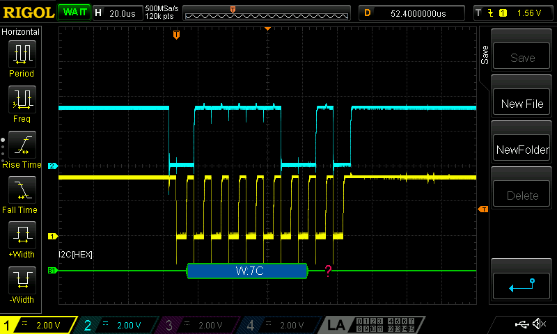

I am using the STM32 Nucleo-L433RC-P development board to send the I2C command, but it is not responding to I2C commands....
I have made the following modifications to the Mikroe Audioamp Click board...
1. Address pin connected to GND (ADR 0)
2. Power select set to +5V
3. I2CVDD pin connected to +3.3V
4. 4k7 pull ups on SDA and SCL connected to +3.3V
Why is the LM48100Q not responding to the I2C command (no ACK) ?
