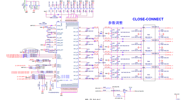

Hi team
The customer tested TAS6684-Q1 in an environment of -40 and needed to preheat for more than ten minutes before it could output normally. Can you help me analyze the reason? The schematic diagram is shown below, thank you!

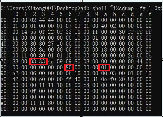

  • Hi Shadow,
    Thank you for your feedback.
    The values read from registers 0x72/0x73 are all 0X33, and the status report shows that all four channels are in a HI-Z state. The Fault state is that the DVDD power on reset event stored and Clock Error event stored(0x86—0x80, 0x8A—0x01). What is the reason for this? Thank.
  • Hi Eric
    It's quite likely the clock is not stable during this situation, and devic is waiting for clock. Let's use oscilloscope to check clock waveform under this condition.
