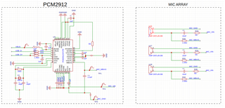

PCM2912A: audio clipping with parallel mic array
Part Number: PCM2912A
Hello Team
We required a far field (15ft) mic array. And since we were on a time crunch, we ended up with PCM2912A and parallel mics. We are noticing clipping and muffled audio. Can someone please help validate the design and provide some feedback.
Rajiv
  • Hi Rajiv,
    The clipping is most likely due to having three microphones all connected at the same node, since they may all have a maximum voltage, then you may have three full-scale signals adding together. See if you can do a voltage divider at the output of each microphone, this may help.
    Mir
