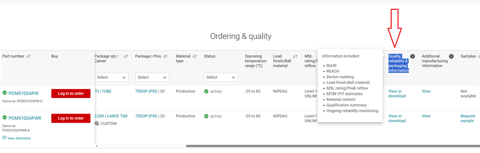

    I believe 4211880 compound should have no problem with copper wiring .  Please refer to this link ( from product page you can also access it). In the Material content section , it lists all the material that is in the compound.
    https://www.ti.com/quality-reliability-packaging-download/report?opn=PCM2704CDB
    Arash
  • You're most welcome.
    The link I sent above  lists all the material that is in the compound. In general for any IC you can find the list  from its product page .  at the bottom of the page from ordering and quality,  select Quality, reliability & packaging information  view and it gives you all information you need.
    Arash
