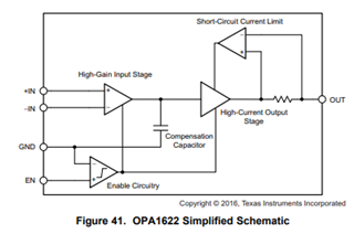

Does TI have BA3121F this kind of Ground Isolation Amplifier? thanks!

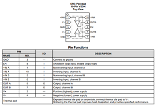

    We do not seem to have p2p replacement or the same product family as BA3121F, Ground Isolation Amplifier. TS5A23159 is analog switch and it may be used for the similar application.  TPA6132A2 may be used for headphone amplifier with pop/click suppression. TLV320AIC3101 may be used for audio codec with integrated mute control, pop suppression, headphone driver. But these products are supported by other TI team. We are specialized in supporting op amp products.
    OPA1622 has En/Disable feature as shown in the pin out. If you are interested in, please let us know.
    If you have other questions,  please let us know.
