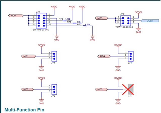

2. As shown in the attached measurement results, the output level differs between Single-end and Single-end w/high common mode. Is it the specification of this IC that the output changes depending on the pin setting regardless of the input level?
TAA5242 MDx setting and Input_Output level - コピー.xlsx
< Setting >
The following settings are made in the Controller mode of the ADC.
MD0: Short to AVDD (Controller I2S Mode)
MD2:1: 2’b01 (CCLK/128)
MD3: 24.576MHz CCLK input
MD5:4: 2’b10 Single-Ended input on INxP; AC-Coupled only
*For measurement, the Digital Serial of the APx555 is connected to the pin header of the External ASI of the EVM.

    ・When Control Mode MD [2:1] = "01," the gain is increased by +6dB compared to other settings.
    ・When Control Mode MD [5:4] = "11," the gain is 6dB lower than when Control Mode MD [5:4] = "10". (It is the same in target mode, so is it a specification?)

    Your observations are correct. When you adjust the MD4/MD5 pin to set the common mode tolerance this will change the effective full scale range of the ADC input and degrade SNR performance.
    This is illustrated for hardware controlled devices in table 2-3, table 2-5, and explained in section 1 of this application note: https://www.ti.com/lit/pdf/slaaeg6
    Additionally, in table 2-4 of the EVM's user guide there are limitations noted for sampling rate and ratios supported in controller mode. https://www.ti.com/lit/pdf/slau904

    I understand that it is a specification that the input range changes by setting MD [5:4].
    Regarding the inquiry that the gain changes by MD [2:1] = "01," I am wondering why the gain changes if the sampling rate Fs=192 kHz is also supported.

    Since I have only one EVM, I cannot evaluate other EVMs. Is it possible that the IC of the current EVM is broken?
    The gain did not change even if I changed the sampling frequency and MCLK (CCLK). Make the following settings (1) and (2), and (2) will increase the gain by +6dB compared to (1) at any frequency.
    (1) MD [2:1] = 2’b00, 2’b10, 2’b11 (-20dB)
    (2)MD [2:1] = 2’b01 (-14dB)
    Also, AVDD was set to +3.3 V, but the gain did not change even if J24 of EVM was set to +1.8 V. (At this time, 3.3 V and 1.8 V voltages are normal.) Previously, you commented that AVDD +1.8 V setting in Target mode should be disabled in Controller mode. Is it possible that it is enabled for some reason?

    I was exploring this further today and have a couple questions. You attached a photo of your EVM in one of the Excels you sent over showing you have an RCA connector connected to the INxP terminals for input 1 and input 2.
    1. Do those connectors come from the same cable? As a differential pair? If this is the case, they should both be visible on the AP scope.
    2. Is that how your cables were arranged for every measurement you took in the table you sent? I am now starting to wonder if the doubling occurs due to full-scale mismatch between differential and single-ended configurations, as this is more likely than my previous theory.
    3. Did you change the input jumpers below when changing between differential and single-ended modes?

  • Hi Garret-san,
    1. They are connected separately from the AP's Unbalanced (Lch/Rch).
    2. I understand that the pin for setting differential and single end is only MD [5:4]. Even if MD [5:4] is set to differential or single end fixed, why does the gain change if MD [2:1] is set to CCLK/128?
    3. Test is set to DC coupling jumper setting.
    I changed several jumpers such as MICBIAS and tested, but the situation did not change. Is there a jumper setting in this that changes the gain if MD [2:1] is set to CCLK/128?

    I noticed you said the jumpers are set to DC coupled here:
    But the configuration you described here suggests AC coupling mode:
    J15, J16, J17, and J18 are always measured in the OPEN state
    I also notice that capacitors C4, C5, C6, and C7, which AC couple the inputs, on your board seem disconnected. Did you physically alter the board at all?

    What exactly do you mean by the customer setting is DC mode? Is this a measurement setting? On the EVM, AC/DC coupling is only set by the jumpers J15-18. Since they are all OPEN, the inputs are AC coupled. If there is a mismatch, this could be causing an issue. I can conduct the evaluation in both modes if necessary.
    However, my larger concern now is that the board is damaged, particularly those capacitors I mentioned previously. This would affect the signal integrity of the inputs in AC coupled mode and could be the reason for the unexpected results. I am looking forward to your response on this.
    Garret
  • I recommend populating jumpers J15-18 and retaking your measurements in DC coupled mode.
  • Hi Garret-san,
    ->There was a mistake in my understanding. Please forget this.
    ->I changed from ceramic capacitors to electrolytic capacitors for C4 to C7. Electrolytic capacitors are soldered on the back of the circuit board. I changed to electrolytic capacitors to improve the low frequency audio characteristics of ceramic capacitors.
    ->I set MD [5:4] =2'b01, 2b'11, and changed MD [2:1]. The result does not change. The gain is 6dB higher only when MD [2:1] =2'b01.
    Nishie
  • Hi Nishie-san,
    This is not the process I was describing. I would like for you to test in DC coupling mode by populating jumpers J15, J16, J17, J18 in order to bypass the hardware changes and isolate the issue to AC coupled mode. These are not the MD pins, those are J71-75. J15-18 are located next to C4-7.
    MD[5:4] pins change the input source (diff/single-ended) and common mode tolerance, not the coupling mode.
    I imagine your issue arises due to the hardware changes made to your board, as I was able to test on my new EVM and could not replicate the gain increase you are seeing by changing MD[2:1]. I recommend getting a new EVM to test on to demonstrate this is not a device issue.
    Garret
  • Hi Garret-san,
    Thank you for the evaluation with the new EVM. This problem occurred before the capacitor was changed. Is it possible to change the EVM to a new one?
    I apologize for my lack of understanding. In my test, I changed MD while connecting jumpers to J15 to J18. Could you tell me the measurement method I will perform again?
    Nishie
  • Hi Nishie-san,
    The measurement method is the same as you did before, by changing the MD pins and measuring the RMS level of the output of the ADC. Can you send a new picture of your board as well as the results for DC measurement?
    Garret
  • Hi Garret-san,
    I am sending you a picture of the EVM.
    The measurement results are the same as what I told you before. The gain is 6dB higher only when MD[2:1]=2’b01.
