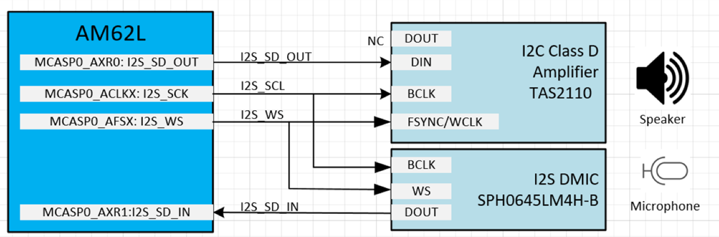

We are planning to use the TAS2110RPPR I2S audio amplifier in parallel to a digital mic (SPH0645LM4H-B) as per the below configuration.
  • Could you please confirm if there would be any issues in using a common clock source for both the DMIC and the audio amplifier? Additionally, we are planning to use the I2S_SD_OUT pin for the audio amplifier input and the I2S_SD_IN pin for receiving DMIC output — is this configuration acceptable?
  • If we are interfacing the audio amplifier via I2S, what is the purpose of the amplifier's DOUT pin? Is it necessary to connect this pin to the host processor?
Please help me to adderess above queries.
Thank you.
  • Hi Fenil,
    Sharing clocks should be OK as long as the frequency of these clocks is supported by TAS2110.
    SDOUT and SDIN connections are also OK in this case.
    SDOUT from TAS2110 is optional, you can use this to send some data back to the host such as VBAT level, Temperature and Gain.
    -Ivan Salazar
    Applications Engineer
    Thanks for reply. As per above diagram I2S_SD_OUT and I2S_SD_IN both pins are configured with audio amplifier and digtal mic. so is the SDOUT pin from TAS2110 can be connected to any other I2S port GPIO or we can left it unused if not necessory.
  • Hi Fenil,
    Yes, you can use a different I2S GPIO for TAS2110 SDOUT signal, or left floating if not used.
    -Ivan Salazar
