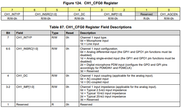

2. For single-end input, is it appropriate to set GPO_CFG0 [3:0] to 0d (disabled)?
3. Other than CH1_IMP [1:0], are there any other registers related to the frequency characteristics and signal-to-noise ratio of the input signal?

    GPO settings having no impact on single ended vs differential configurations. The only thing that matters is the CHx_CFG0 config registers
    ->3. When using the CHx_CFG0 register, could you please tell us if there are any precautions regarding the use of Microphone input and Line input, and the difference in electrical characteristics?

    There's no difference in electrical characteristics when using mic or line input. It's just a label for the user.

    2. For example, whether I choose to input a signal directly from an ECM or MEMS microphone or from an amplifier, does the setting of the CHx_CFG0 register matter, and if I set the bias voltage and PGA in another register, will there be no problem in operation?

    2) CHx_CFG0 does matter, but bit 7 does not matter. It has no impact. However when switching from MIC to AMP or AMP to MIC, the register will probably stay the same except for SE vs DIFF input.
