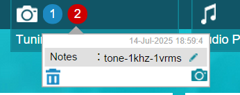

  • Hi, Wenbin.
    Thank you for your answer.
    I will ask additional questions about each.
    1. So, by inputting an I2S signal to SDIN, the tone is output. Doesn't that condition apply to the Audio Player in PPC3? I expected that the sound being played by the Audio Player would be input to the TAS2563 as an I2S signal.
    2. I was able to open the PPC3 file for now. When I clicked on Snapshot 2, it displayed "Applying Snapshot" as shown in the picture below.
    After this, how can I output the Tone?
    3. So the Tone Generator can only be controlled in ROM Mode?
    I'm sorry that I'm slow to understand because I don't have much knowledge about this. I would appreciate it if you could explain it to me in an easy-to-understand way.
    Fumiya.
  • Hi Fumiya,
    answers:
    1 the internal audio player or external player are all input to the chipTAS2563 as I2S signal.
    2 in my experience, maybe you need play a very short signal via audio player, it will be a trigger to enable the device. and after that, there will be the tone for continues.
    3 there is only one tone controller in TAS2563. in ROM mode, you can control it freely. but in tunning mode, the tone generator is used to generate the pilot tone, it must be matched with the algorithm. so it can't be used freely.
    Br,
    Wenbin
