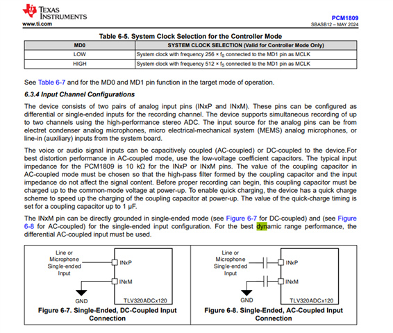

I am wondering how different the dynamic range is between AC and DC coupling the inputs like this.
Is it still possible to get the full-scale input if both INxP/M are differentially driven regardless of DC/AC coupling?
