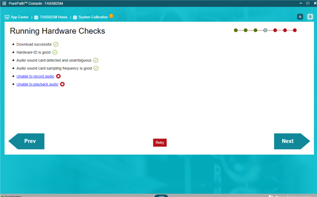

The purepath console 3 fails the hardware tests when using the purepath console motherboard with the tas5825m evm module
*Windows 11
Power supply 12 V
I ordered another EVM module but it exhibits the same problem as the first. I have rebooted, reconnected, cycled power
  • Hi Stephen,
    Is the audio output and input device on your computer routed to the EVM with the volume at 100%?
    You can also skip this step and see if you can play audio at some low level. Sometimes computer specific settings can cause this hardware check to have a false fail for playback and recording.
