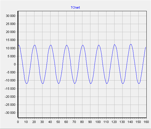

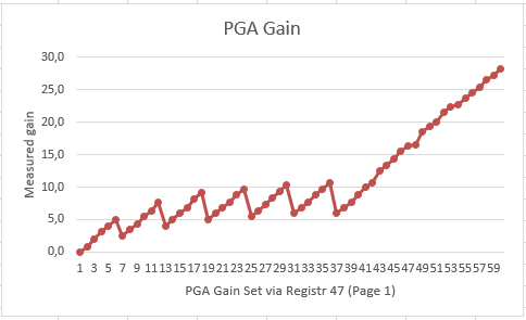

I have encountered an inconsistency in PGA Gain setting. When I gradually increase the value in Page 1 Register 47 the measured gain doesn't increase gradually, but there are drops in gain at some values. Please see included graph.
The drops in gain are at the following Page 1 Register 47 values: 12 (6 dB), 24 (12 dB), 36 (18 dB), 48 (24 dB), 60 (30 dB), 72 (36 dB)
I should note that AGC is switched off.
  • Hi Stanislav,
    This looks like the measurement tool is scaling its range as the input signal increases and might be leading to strange results.
    Can you give more detail on how this plot was taken? How is the input signal being adjusted to prevent clipping?

  • Hi Jeff,
    I can exclude clipping as well as measurement tool scaling. The measurement arrangement is as follows: Analog input MIC1LP is driven by a sine wave from a signal generator. The digital output from audio codec is transferred to a data stream. The data stream is analyzed on PC by special SW, that can draw signal from received data - please see attached file. As you can see, the output digital signal is not clipped. I should note that we use the measurement arrangement for years as we are producer of VoIP communication systems and we use various audio codecs (from Conexant, Wolfson).

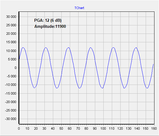

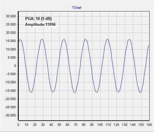

    Here are the measurement values around the "drop gain point (6 dB)":
    Input analog signal amplitude: 500 mV (1 V peak-peak)
    ADC Digital gain (Page 0 Register 83) Value: 0 (0 dB)
    PGA Value:                    Measured digital amplitude:
    8 (4 dB)                          14460
    9 (4.5 dB)                       15484
    10 (5 dB)                        15996
    11 (5.5 dB)                      16764
    12 (6 dB)                         11900
    13 (6.5 dB)                      12412
    14 (7 dB)                         13436
    Notes:
    1. I attach a few output signal graphs. I should note that in the digital data stream path is a G711 mu-law codec that brings a quantization error. Anyway the quantization error is small (in the order of tents dB).
    2. The graphs are not 100% perfect as they are drawn by connecting the discrete measured values by lines.

    I was able to test this today and verified what you were seeing - there are jumps in the output dBFS digital "volume" of the input signal. I think there are a few reasons why we are seeing this behavior, and some interesting avenues to explore.
    My first suggestion is to assign something on the M terminal of the ADC, this is with page 1 register 49 (0x31). When it is set to common mode, we see a 6dB increase in the output dBFS, and the jump at 6dB of gain does not occur anymore. However, we reach full scale a lot sooner, actually around 5 or 6 dB of gain (since it starts at around there). When we change register 83 to the max digital volume reduction on the ADC, -12dB, we still see the jumping in gain when the M terminal is not set, but when it is, we avoid the gain jump but experience distortion around 6dB still. This is likely due to the stage at which this gain reduction happens - the PGA is the first thing that happens to the input before it even goes into the ADC, so if the ADC receives a signal that is too high, it will not be able to decrease it digitally while keeping the distortion down. The distortion occurs when the signal is too big going in to the ADC. We can measure the distortion with a THD measurement.
    What is interesting to me is the jumps in output THD as compared to the PGA gain when you do not have anything connected to the M terminal happen at these few set values every 6dB of gain, and then after ~42dB, the distortion overtakes the gain error and it finally looks like it is clipping, similar to how my 6dB of gain looked on the input signal when the M terminal was set. I measured THD alongside the dBFS value for many different PGA gain levels and saw that after each "jump" in the gain, the THD got worse by around 5-6dB as well. The gain jumps were around 4-5dB increase from what was expected of the output at those points. From these values being similar, I would guess that internally there are these plateaus of PGA gain, where the signal maybe would clip if it was balanced correctly, but maybe the ADC itself cannot recognize the signal correctly when there is nothing to "compare" on the PGA. Just an idea.
    If you can change that register to set the M terminal to the common mode, and then decrease the analog signal coming in to the device, we can make sure that there are no more strange discrepancies in the PGA gain. But, I think this should solve your problem. Sorry about the delay here again. I am happy to test this more if you need me to.
    Mir
