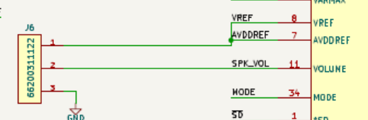

Latest update : MODEOUT PIN is now coming High when MODE pin LOW
Apologies for the delay here!
I see in the schematic it seems just one pin is connected for PVCCL/R and the output pins, but there are various pins of that value that must be shorted together. Can you confirm if all pins are connected?
Also what are the voltage values of AVCC and PVCC and what is the voltage in % of VREF on the volume pin?

PVCCL/R & Output pins are overlapped & connected in the schematics.
AVCC = 12V
PVCC = 12V
VREF = 4.7V
VDD_SPK_AMP = 12V
Your schematic and these ratings look okay. Can you explain how this jumper is configured?

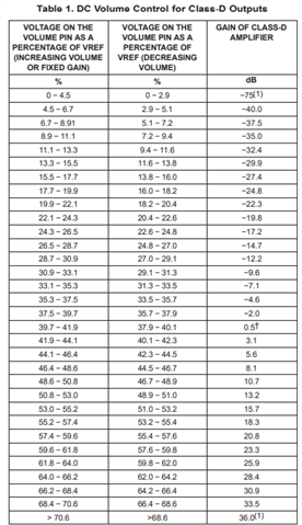

What is the voltage on the volume pin?
Also are you measuring RINP before or after the input cap C5?
Sydney Northcutt
Are you changing the value of this pin? You mentioned this pin was connected to a potentiometer. It should be some percentage of the VREF voltage. Is the VREF voltage changing?
Looks like the output is changing with the volume pin which is good. Are you now getting the correct output and sound out of your speaker?
