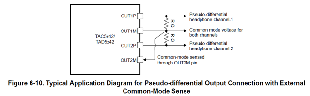

We have a question regarding TAD5242 audio DAC.

Hi Jeremy,
The common mode voltage is generated by the device on the OUT1M pin, and it is a non-zero voltage.
It is sensed back by the OUT2M pin of the device.
The swing on the OUT1P/OUT2P will always be above 0V in this configuration.
Thanks and Regards,
Lakshmi Narasimhan
Hello Jeremy,
The common mode voltage is internally generated . Pseudo-differential connection for one channel is shown below.
Arash
Hello Jeremy,
Even if there is an accidental short on its output , it should not get damaged.
Kind Regards,
Arash

We wanted to be sure they won't be an issue with our design so :
The DAC has short circuit protection and in the case of any short circuit even, it will shut down and there will be no damage to the IC. Once the short is removed, It has to reset/powered up again.

HI all,
On last question regarding this topic.
Hello, In headphone mode the range of acceptable load is from 8 Ohm to 300 Ohm with 16 Ohm being nominal. If headphone is removed, then there is nothing there to be driven at those pins.
Arash
Noted. It does not answer our question but anyways we have put some protection resistors in our design in case of.
Jeremy
Seems you externally did reinforcement as well. Should be okay.
