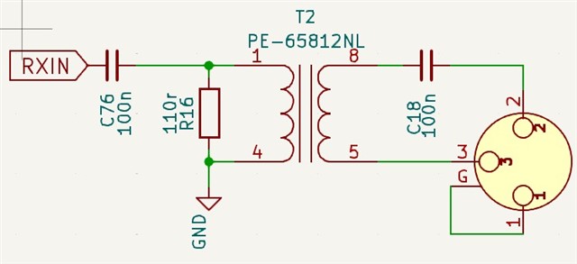

DIR9001: Is this a viable AES-3 input circuit?
Part Number: DIR9001
I want to use the DIR9001 as an AES-3 receiver, is the circuit below viable and compliant with AES specifications? As RXIN is 5v tolerant I assume I don't need a pad and with the use of a transformer I shouldn't need a seperate balanced to single ended converter IC, correct? Transformer is 1:1
Many thanks.
