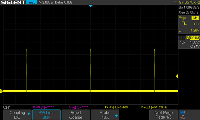

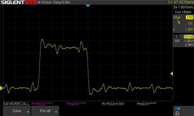

    1) Can you share a scopeshot of the FSYNC waveform at the device pin, do we see any glitches on the FSYNC signal?
    2) Do we see this behavior respond to sampling rate (eg. 48kHz) or BCLK (eg 128*FS instead of 256*FS)?

  • Hi Lakshmi,
    Here are a couple of 'scope grabs of the FS pin.
    So changing the sample rate to 48kHz with a BCLK ratio at 256 results in the ASI_STS reporting 0x72! Weirder – now it gets the sample rate wrong AND the clock ratio.
    Thanks for your support on this – really appreciated.
    Adam
  • Hi Adam,
    Thank you for sharing the scope captures. The behavior you've mentioned at 48kHz does look weird.
