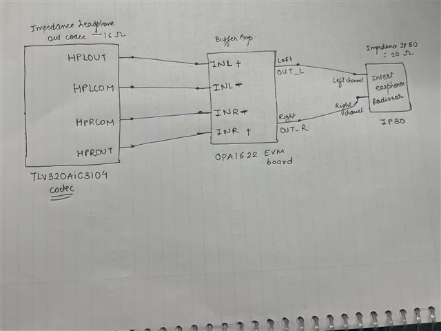

  • Hi team ,
    I am working on a design where I am using the TLV320AIC3104 codec to drive insert earphones (IP30). The headphone outputs of the codec (HPLOUT, HPROUT) are routed to a buffer amplifier (currently using OPA1622 EVM board as shown in the attached schematic).
    • Codec headphone out impedance: ~16 Ω
    • Earphone impedance: ~10 Ω
    • Buffer amp used: OPA1622
    • Also considering: MAX97220 as an alternative
    My questions:
    1. Will the low output impedance of the buffer amplifier (OPA1622) be sufficient to properly drive IP30 insert earphones?
    2. Between OPA1622 and MAX97220, which would be more suitable for driving low-impedance earphones in terms of audio performance and matching?

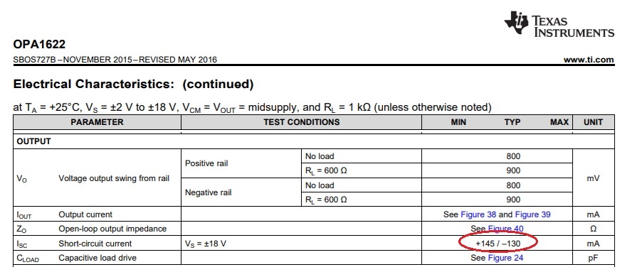

    Your main challenge in driving 10 ohm load of IP30 will be sufficient output current drive and output swing to the rails and not matching (?).
    OPA1622 has very high output drive (see below typical 145mA/-130mA) so it can drive output to at least +/-1Vp (Iout=+/-1V/10ohm = +/-100mA).

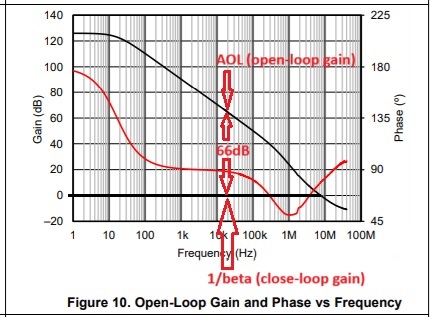

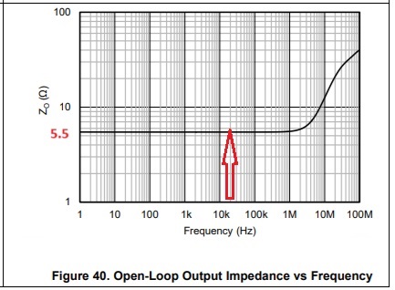

    The open-loop output impedance of OPA1622 is 5.5ohm (see below) at 20kHz but you need to use a close-loop impedance, Zcl=Zo/(1+AOL*beta), to determine attenuation.
    Since AOL is about 66dB (2,000 on linear scale) and for buffer 1/beta is 0db (1 on linear scale), Zcl=5.5ohm/(1+2000*1) =~2.75mohm.
    Thus, the attenuation of the output signal due to finite Zcl will be (0.00275ohm/10ohm)*100%=0.0275%

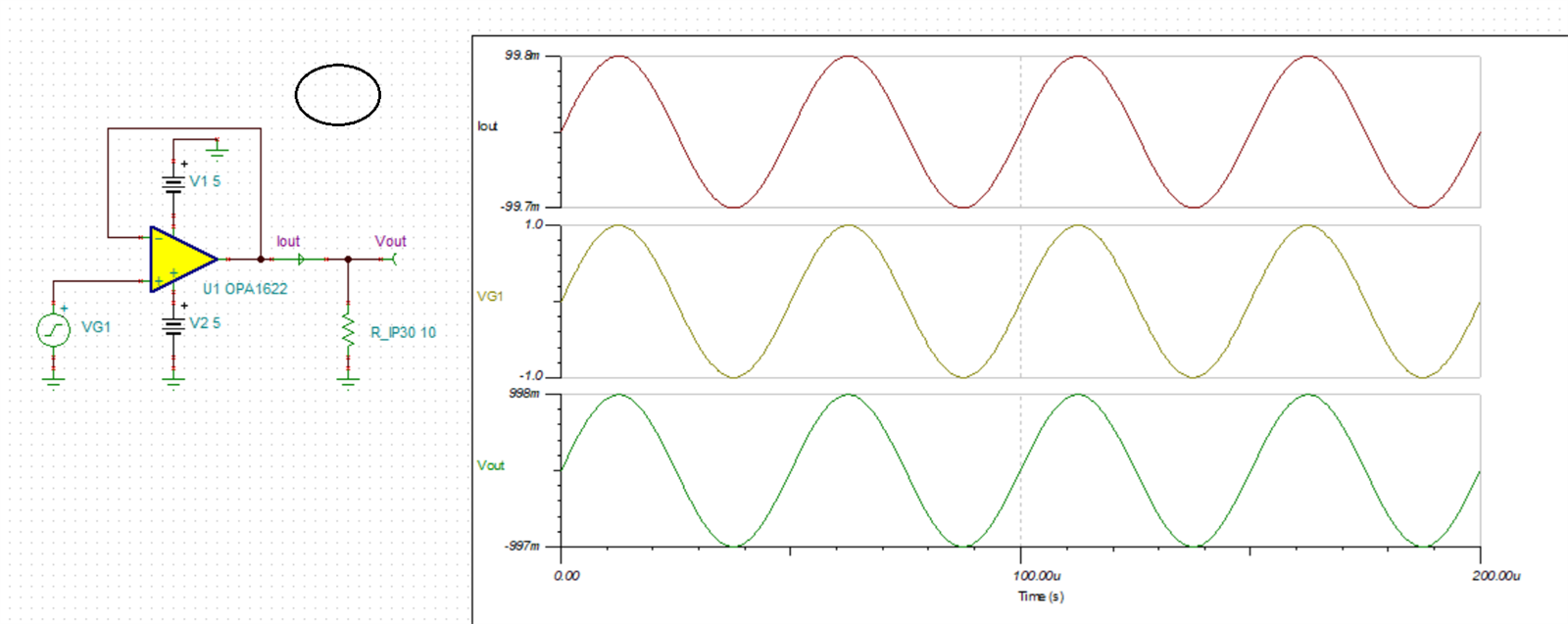

    Running transient simulation with 1Vp input voltage shows OPA1622 buffer delivering close to +/-100mA current with little attenuation - see below.

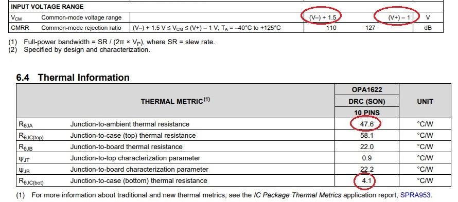

  • In order to answer your question about reliability, it would be necessary to know what is the supply voltage and the output voltage swing.  Assuming it's 5V single supply with output +/-1Vp between 1.5V to 3.5V (to avoid input common-mode distortion-see below) and load connected to mid-supply (2.5V), the average power dissipation inside the package would be P_avg=IQ*Vcc+Iout_avg*Vdrop = IQ*Vcc + {1Vp/[sq-rt(2)]/10ohm}*(5V-2.5V) = 2.6mA*5V + {0.707V/10ohm}*2.5V = 13mW + 70.7mA*2.5V = 13mW+177mW = 190mW
    Considering the junction-to-ambient thermal resistance is 47.6C/W (see above), this would raise junction temperature above ambient by only 9 degrees (0.19W*47.6C/W), which would be very reliable for the life of the product defined as ten years.  For higher supply voltages, you may need to use bottom heatsink with junction-to-case thermal resistance of 4.1C/W to prevent excessive increase in junction temperature, which could shorten expected life of the product.
