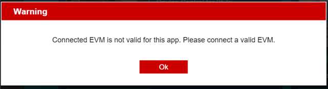

I use the latest PPC3 V3.3, it seems cant not recognized AC-MB
The error message as below:
Part Number: TAS2572
Hello
Hi Chih-sheng,
Can you please read the memory on address 0xa0?
If this memory is empty, please remove the jumper on J74, power on the EVM, and connect to the I2C master in PPC3. Then press connect, paste the script (included below) and then press execute. Then replace the jumper on J74 and try to connect to the PPC3 app again.

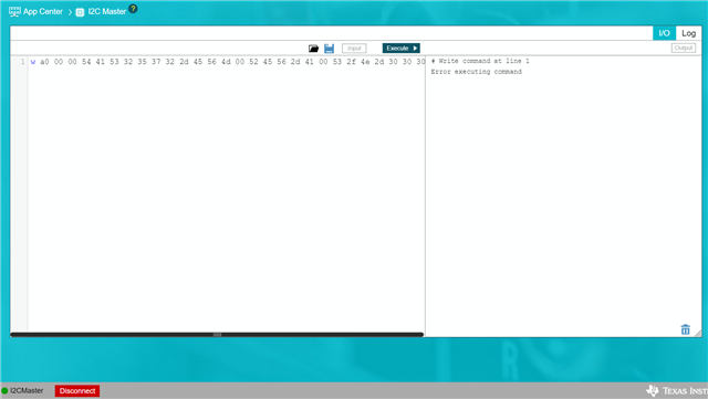

Hi Ivan
I already install I2C Master App successfully
The read format is "r a0" ?
I try to wirte "w a0 00 00 54 41 53 32 35 37 32 2d 45 56 4d 00 52 45 56 2d 41 00 53 2f 4e 2d 30 30 30 30"
Hi Chih-sheng,
The read format is r xx yy zz:
Can you share pictures of your EVM? I want to double check your jumper settings.
Please also provide details on how you're powering up the EVM.
At this point, I think there's some issue with the power or jumper settings that prevents the proper I2C communication.
