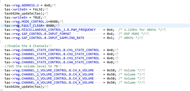

hi have configured the below registers , for TDM application , but i am not getting the audio output, could you please verify the registers which i have configured, is that enough or do i need to configure any other registers?
here sampling rate is 48khz,32 bit 8 channel, and also i am getting fault led on,
