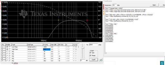

  • Hi Gene,
    Yes, if your noise is at specific frequencies, you can implement up to 3 biquad filters on each ADC channel. You can read more about the biquad filters in this app note: www.ti.com/lit/ab/slaaeh6/slaaeh6.pdf
    Mir
  • Hi Jeffres
        I found the tac5111 biquad filters not take effect,  I use the TIBQ calculator tool  to generate the Coefficients  and write to register, please help check it
    below is the command for channel 1;

  • hi Garret
         sorry for wrong result, after verify again, actually the tac5111 biquad filters is take effect . but we found the biquad filters doesn't have much effect on background noise,  the normal voice and background noise gain both decreased or increased at same time, may be the way we used is not correct. so do you have any suggestion to use the biquad filters?
        Actuall we don‘t have a Spectrum analyser, so we don't konw the noise frequency,also we don't have much experience in noise suppression, base on your experience,  for this case, do you know common noise in the circuit? what type of filters are common used ?
      Looking forward to your experience guidance, thanks

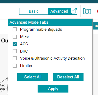

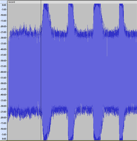

    From the audio file in this, we can see that your signal is clipping, so the gain is too high. I see in register 0x52 you have set to 29.5dB of digital gain on the ADC CH1, and I see that the AGC is disabled for this configuration.
    If we zoom in and set it to dB, we see that your noise floor is around -25dB, if the 29.5dB of gain was not present, the noise floor would be around -55dB. So, you could set the AGC to have a noise gate that kicks in around -55dB and your target level ~-12dB or so, so when your signal is detected over the noise floor, it will reach a max gain below the clipping gain value of 30dB extra. I would recommend using PPC3 to program the AGC.
    Use PPC3 to configure the AGC here:

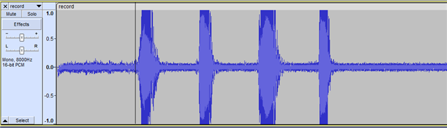

  • hi Jeffres
        I have done as you said for AGC, but still have strong  background noise. I attach record sample in below docx file, please help check , for register 0x52 , I set it 0 dB
    to_ti_0813.docx
  • In addition, Can we use  tac5111 biquad filters to filter the background noise ?  even we open the AGC,  the background noise still increase with normal voice, does the voice and noise overlap ?
  • Hi Bert,
    Looking at your updated audio signal, many of the noise artifacts were removed, but much remained, as any noise above the -55db noise threshold is amplified by the max gain 21.5dB. It appears that with an amplified noise floor of up to -25db, your actual noise floor is around -46dB.
    I would try to increase this noise floor to eliminate more noise, possibly all the way up to -40dB, or maybe -45dB will work. Also, increasing your target level and decreasing your max gain could help to differentiate the noise further.
    Biquad filters will be difficult to implement without knowing the exact frequency of the noise, and could affect the intended input signal.
