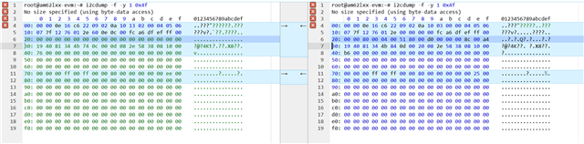

  • Hi Saurav,
    It seems the reg dump you shared is from a different page than 0.
    The commands suggested by Shenghao should allow you to move into page 0 and then make the reg dump of that page.
    Regarding PLL settings, this is usually set automatically by the auto-detect feature. You can confirm if this feature is enabled by the status of AUTO_RATE bit in register 0x06.
    Based off the logs you've shared so far, I assume FSYNC = 44.1kHz and SBCLK = 2.8224MHz, is that correct?

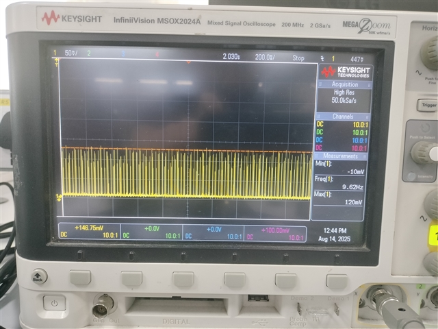

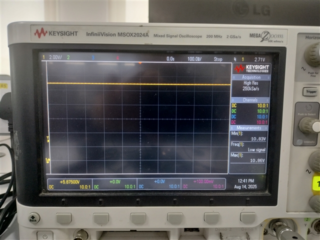

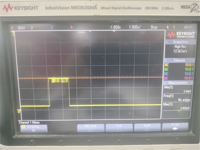

  • Hi
    I got all the clock but when did apply command i got error and also I didn't get any audio

  • Hi
    1. Further update , now I2C and I2S are working fine and no longer seen error. But still we are not able to hear voice from speaker despite there are no error in dmesg log. Please review attached pic , we have measured on J10 connector we seen spike on that. Please find attached resistor dump
      please find attached image and registor dump
    2. I am not able to see *.pp3app configuration for TAS2110 for configure amp. Please help me to getting
    3. this file.
      root@am62lxx-evm:~# i2cset -y -f 1 0x4F 0x00 0x00
      root@am62lxx-evm:~# i2cdump -y -f -a 1 0x4f
      No size specified (using byte-data access)
           0  1  2  3  4  5  6  7  8  9  a  b  c  d  e  f    0123456789abcdef
      00: 00 00 0e 16 c6 22 09 02 0a 10 13 02 00 04 05 06    ..???"??????.???
      10: 07 7f 12 76 01 2e 60 0e 0c 00 fc a6 df ef ff 00    ???v?.`??.????..
      20: 00 00 00 00 00 00 00 00 00 40 00 00 00 00 00 00    .........@......
      30: 19 40 81 34 4b 74 0d 00 0d 08 2e 58 38 08 10 00    ?@?4Kt?.??.X8??.
      40: 76 00 00 00 00 00 00 00 00 00 00 00 00 00 00 00    v...............
      50: 00 00 00 00 00 00 00 00 00 00 00 00 00 00 00 00    ................
      60: 00 00 00 00 00 00 00 00 00 00 00 00 00 00 00 00    ................
      70: 00 00 00 ff 00 ff 00 00 80 00 00 00 00 00 ee 00    ........?.....?.
      80: 00 00 00 00 00 00 00 00 00 00 00 00 00 00 00 00    ................
      90: 00 00 00 00 00 00 00 00 00 00 00 00 00 00 00 00    ................
      a0: 00 00 00 00 00 00 00 00 00 00 00 00 00 00 00 00    ................
      b0: 00 00 00 00 00 00 00 00 00 00 00 00 00 00 00 00    ................
      c0: 00 00 00 00 00 00 00 00 00 00 00 00 00 00 00 00    ................
      d0: 00 00 00 00 00 00 00 00 00 00 00 00 00 00 00 00    ................
      e0: 00 00 00 00 00 00 00 00 00 00 00 00 00 00 00 00    ................
      f0: 00 00 00 00 00 00 00 00 00 00 00 00 00 00 00 00    ................

    Do you mean J10 from EVM? This is speaker output, you should see this pin go to about the same voltage as PVDD when device is Active.
    The value on register 0x24 and 0x25 don't show any error. Perhaps the device is being reset. Do you know if SDz is being toggled? or if power supply is being turned OFF at any point?
    If you need to get access to TAS2110 app for PPC3, you can request access using this link: https://www.ti.com/drr/opn/TAS2110-GUI
    -Ivan Salazar
    Applications Engineer
    J10 Pin Voltage
    When device is active
     Please  review PIC
    Before aplay command 0x24
    0x00
    After aplay command 0x24
    Value : 0x04
    Interrupt due to TDM clock error 0b = No interrupt 1b = Interrupt
    0x25 is 0x00.
    PVDD
    SDz is connected with High.
    register dump before aplay command and after aplay command

    in update , now we are able to hear the voice from speaker, but voice is very low.
    For that we need to set register configuration
     i2cset -y 1 0x4F 0x00 0x00
      i2cset -f -y 1 0x4f 0x00 0x00
     i2cset -f -y 1 0x4f 0x33 0xA0
      i2cset -y -f 1 0x4f 0x08 0x0d
       i2cset -y -f 1 0x4f 0x07 0x02
       i2cset -f -y 1 0x4f 0x06 0x08
     i2cget -f -y 1 0x4f 0x11
      i2cget -f -y 1 0x4f 0x06
      i2cset -f -y 1 0x4f 0x06 0x09
      i2cget -f -y 1 0x4f 0x07
      i2cget -f -y 1 0x4f 0x33
      i2cget -f -y 1 0x4f 0x08
      i2cset -f -y 1 0x4f 0x08 0x3d
    still any pending register to set for volume or any other configuration
    also add waveform of i2s interface please check and tell if any error or not.
