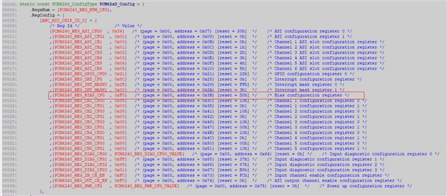

Register setting as below:
Looks they are using correct setting, do you have any ideals to debug this issue? Thanks for your support

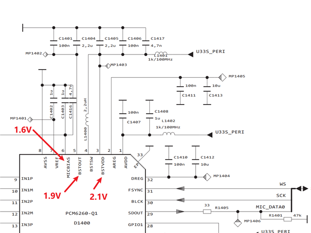

  • Hi team,

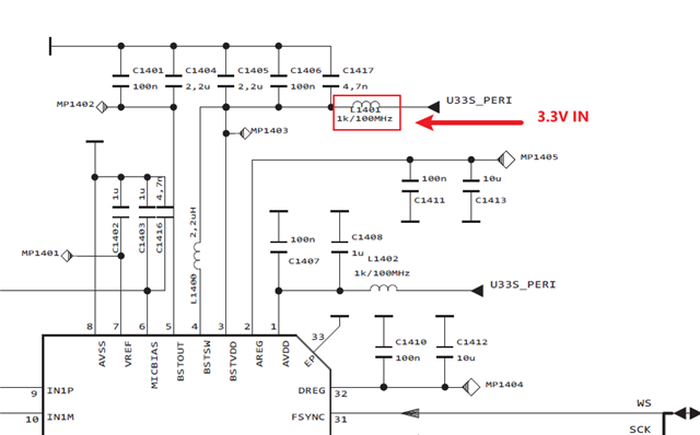

    Today we have replicate this issue again. When issue happens, we test the pin voltage and found the U33S_PERI=BSTVDD=2.1V, BSTOUT=1.6V, and MICBIAS=1.2V. In normal condition U33S_PERI should be 3.3V, so we doubt that PCM6260 cause the U33S_PERI 3.3V drop.

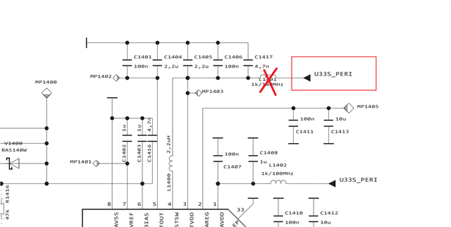

    Then we disconnect the L1401 in this issue condition without power off the board, U33S_PERI recover to 3.3V.  And after we power off the board and reconnect the L1401, then power on, the issue disappear.
    Have you met such issue before? And can you please provide some suggestions for issue analysis?

    I suggest removing the schottky diodes on the pull up of each input line to MICBIAS.
    I also suggest placing the unit with MICBIAS error on an EVM and placing a new IC on the customer test board without the diodes.
    I will ask customer to try this.

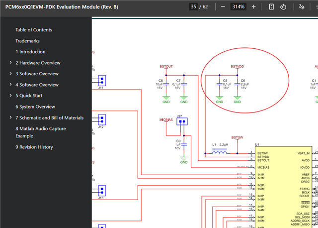

    I missed your comment about the inductor. We typically recommend a 600Ohm at 100MHz inductor here. It is possible for the current inductor to be too large, which slows the charge of BSTVDD, delay startup, or limit current and lead to MICBIAS undervoltage.
    The exact inductor used on our EVM is listed in the user's guide.
    I didn't see 600Ohm at 100MHz inductor is used when I review the EVM user guide.
    The results we observe is the BSTVDD always 2.1V when issue occurs. So is it possible that PCM6260 cause the U33S_PERI drop? U33S_PERI is 3.3V when the board works well.
    Xiaowei Zhang
  • HI Xiaowei,
    Yes, i think that could be the issue. BSTVDD supply should be a stable 3.3V.
    As a sanity check for proper operation, BSTOUT should always be ~1V-1.5V higher than the programmed MICBIAS value.
