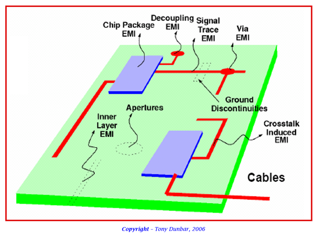

     From my past experience,  EMI/EMC issues are mostly layout and component related issue. For example,  in one case we replaced the power supply with a 12V battery to improve the EMI and to our surprise, EMI got worse and replacing the battery with another type of  battery helped the EMI. Ferrite bead, twisted cables and enclosures are all common practices to reduce EMI in general . I am sure you already know this but I add the EMI sources  here for future users reference:
    • Integrated circuit (I/O switching)
    • Package Leadframe  &  Bond wire
    • PCB tracks
    • Via
    • Ground and power planes
    • Cable assembly
    • Apertures / seams
    Here are few references that you should be able to access these and more from ti.com
