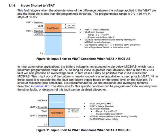

Hello team,
VBAT_IN Max is 18V. It cannot connect to battery supply directly considering surge damage.
Could you teach me recommended connection for VBAT_IN in 12V battery vehicle systerm?
Also I want to know quiescent current because I can't find in datasheet.
