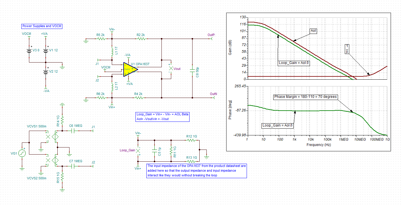

How do I show the phase and gain graph attached?
Attached graph's label shows AOL. however I think it is circuit is closed loop gain.
Can I get to simulate result of phase and gain for closed loop gain(0dB buffer) circuit?
Since it is set to 0dB buffer, the closed loop phase margin of 0dB cannot be used to determine stability, so I guess it will have to be verified by the amount of ringing?

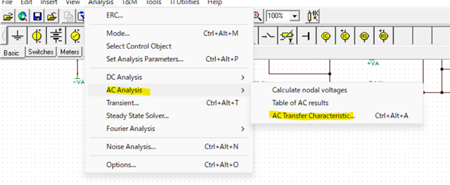

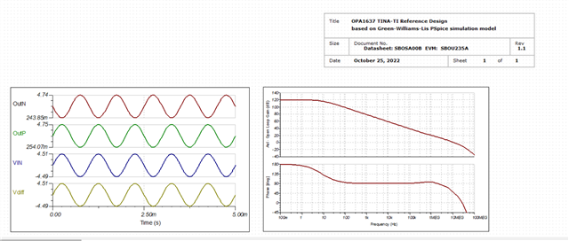

I tried to simulate AC analysis, however it seems to get same result.
