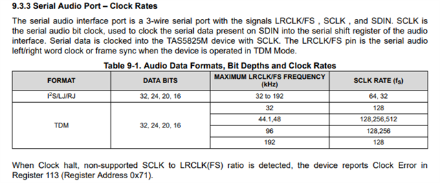

We encountered an issue with the TAS5825M amplifier in PBTL mode:
  • When using an audio source with LRCK = 48 kHz and SCLK = 2.304 MHz, the TAS5825M produces no output (no PWM signal observed).
  • However, when switching to LRCK = 48 kHz and SCLK = 3.072 MHz, the device works normally.
Request:
Please help identify the root cause. Why does the TAS5825M fail to operate at SCLK=2.304MHz despite both configurations using LRCK=48kHz?
