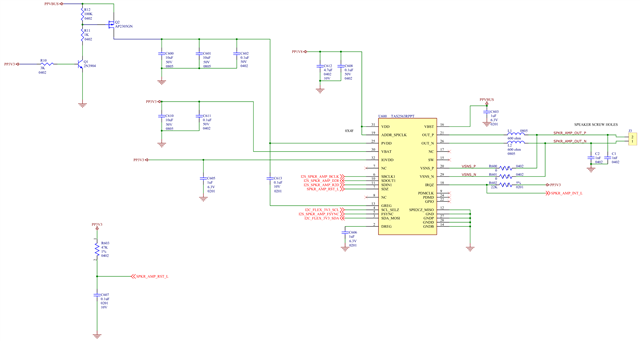

Hello!
We have been using TAS2563 in our design, integrated with the Linux driver.
Whenever we stop playing audio, we can hear a "plop" sound at the end.
This happens in the following cases:
  • Playing audio, then stop
  • Playing silence, then stop
  • Playing audio, then muting (Chn0B0x00P0x00A0x02: 0x01)
  • Playing audio, then issuing Software Shutdown ((Chn0B0x00P0x00A0x02: 0x02)
Also, if the volume is lowered down modifying the AMP_LEVEL bits of  Chn0B0x00P0x00A0x03 you can hear a "plop".
In this case, the magnitude of the plop is proportional to the jump (example: 0x10 to 0x01 > 0x10 to 0x0F).
Can you help me identify if there is a software option to decrease this noise or if it's hardware related?
You can find our schematics here:
And register dump here:

    If this only occurs in your custom system, perhaps what happens is that input clocks (SBCLK and FSYNC) are suddenly stopping during playback stop. The clocks should be present whenever the device is Active through register 0x02. This would not explain the sound during mute command though.

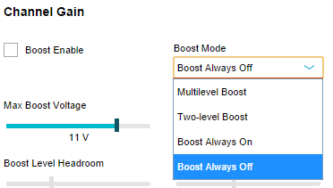

    One important thing I noticed in your PPC3 file is that the boost controller was set to Always On, but it must be set to Always Off. The Boost ON/OFF control is still Off, so that's OK, but the boost controller should still be set to Always Off.
    You can try increasing the volume ramp rate, although this would help during mute and SW shutdown sequence, don't think this would affect the playback stop sequence.

    I have been doing some trial and error with the parameters you're describing on our device. So far, I haven't seen any impact.
    Setting the Boost to Always Off had no effect either.
    I ran another test with interesting results: I've played a "silence" audio file in the background. While it was playing, I ran all procedures that normally trigger the undesired sound, and there were no signs of the issue. Afterwards, I stopped the silent playback and ran the procedures once again, in all cases I've heard the sound.
    This suggests a problem in the output stage. Would you agree with that?
    About the troubleshooting:
    From what I understand, your suggestions are meant to enforce best practices and rule out confounding factors, not because we already have a clear root cause. Is that correct?
    From the schematic, do you see anything that could be causing this issue? If yes, is there a way to improve it?

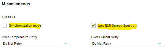

    If the feedforward mode didn't solve the original issue, I don't think it's worth disabling the protection.
    At this point the thing that still puzzles me is that you don't get the plop sound if you play silence continuously in the background.
    You can try toggling either the Spread Spectrum to be OFF or Sync mode to be ON. This helped with some noise issues in the past when using external PVDD mode (boost OFF). Although your problem doesn't seem to be the same.
    -Ivan Salazar
    Applications Engineer
  • Hi Ivan,
    I cleared BST_SYNC in BOOST_CFG2 and AMP_SS in MISC_CFG1, the artifact persists.
    Is this sufficient for your test plan? Also, which tool are those screenshots from?
