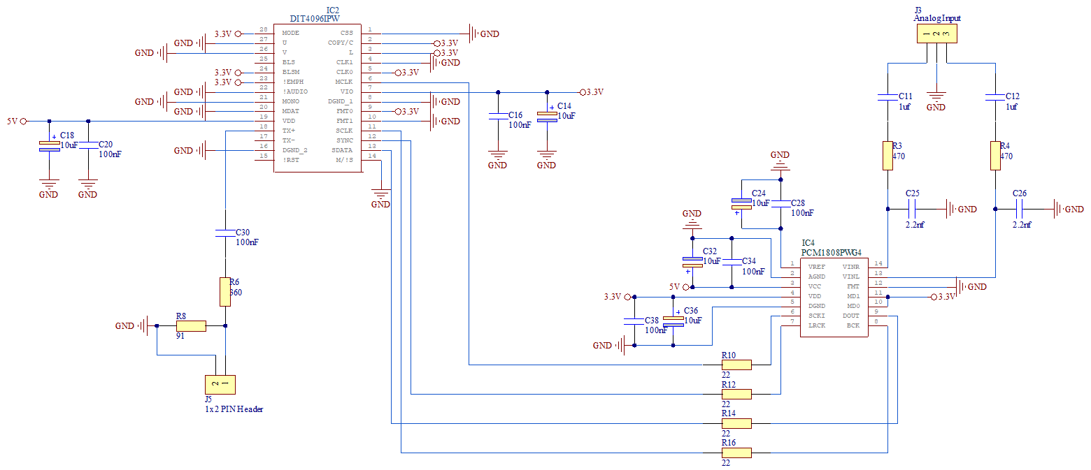

I have made the project from the Schematic added here. Created a PCB and after powering it on it seems that it doesn't work.
After reviewing several times the connections i came t the conclusion that something is wrong with the schematic itself and tried somehow to understand more and i definitely need some help as after me it seems that everything is fine.
Can someone help with a review and advice?  I really don't know what is wrong or what i am missing!
Please note that for the RST pin i used a MCP130 that will handle the reset, and some decoupling caps are missing for simplicity.
Thank you!
    I assume you are using the ADC in master mode and want to send  the  generated I2S signals form ADC to AES3 format .  Have you measured to see if  the I2S signals  that are coming out of ADC  are correct? Also note that SCKI for ADC has to be provided so it can be used internally.
    Please describe the issue in more details: What is working fine and what is not working?  I understand that the system as whole is not working but can you explain what signals you have tested so far ,  what is working and what is not working as you expected.

  • Hello  ,
    What i want to do is exactly what you assumed. I want to send the ADC audio signals via coaxial cable (maybe toslink, stil not sure yet) to a DAC.
    Unfortunately my scope (3 in 1) broke down a couple of days before my tests, another one it's on his way back to me, but until then (mabe a week or so...) i don't have any means of measurements, except a simple plain multimeter (as simple as it can get, bought from the local store for emergency purpose). All i can check is that SCKI has around 1V when no input signal is present on the ADC input and around 0.3V when signal is applied. The rest are 0V, maybe also the multimeter cannot measure correctly.
    "Also note that SCKI for ADC has to be provided" - stupid me.......i was so focused on to check mistakes that i totally left this part out.... It seems that also the DIT4096 needs one....  Rookie mistake as it's the 1st time i am using DIT4096 (or any similar transmitter).
    Thank you!
    LE: A  PLL1708 will be good enough if i use SCKO1 for the configured 256fs ADC/transmiter? Again maybe a bit stupid question but i never doubt with something similar...
    As well can i use the same clock source to provide the clock for more than 1x PCM1808/DIT4096. (in my theory should be double)
  • Hello, The lack of master clk in your schematic is the main issue. Unfortunately for clks you have to have scope so you can verify the full spec of the clks. Especially if ADC is set in master mode , you have to make sure the generated  I2S ( from ADC) is what you think it is -before you send it to DIX device.
    I am  not familiar with PLL1708I but it seems it  is a  good option for SCK.
    If you still have any issue after providing correct clocks, let me know.
    Arash

    Once you have the- master clk fed to ADC, I don't think you should have any issue . ADC is very straight forward and you should  be able to verify the ADC conversion first and once it is stablished I don't think you should have any problem with the DIX device. Nevertheless scope has to be handy to move on.
    Arash
