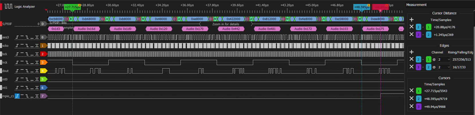

Currently, I'm testing the DIR part of the chip; the output will go into an FPGA to do channel demuxing, but right now I'm just looking at my logic analyzer.
The chip seems to be working correctly; decoding works just fine.
However, I just noticed the horrendous delay between a B-frame preamble and the BFRAME signal actually being raised (which, after re-looking at the datasheet seems normal).
Here is a logic analyzer capture.
Is there an alternative way of signaling the B-frame that would be more presice?
Or if not possible with the chip is there another that wouldn't have such delay?

    So, after re-reading the datasheet and doing a new capture with the logic analyser, I can confirm that I'm an idiot.
    It was late, and I got confused while reading and thought that tlate was the delay between a sample on DATA and BFRAME.
    I now realize that tlate is the global latency of the system, including data and sync signals.
    And that the delay between DATA and BFRAME is ~17BCK.
    I apologize for any confusion,
    Thanks for the help,
