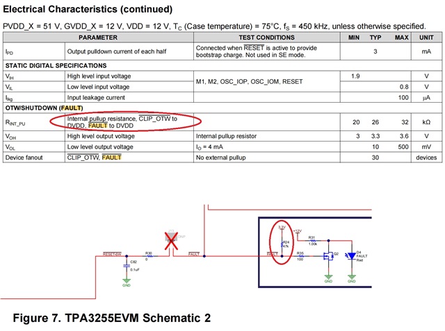

TPA3255EVM: confused on the fault pin connection
Part Number: TPA3255EVM
Hi team,
From the datasheet 'OTW/SHUTDOWN (FAULT)' section of Electrical Characteristics (continued), it says there are internal pullup resistors of 26k for FAULT/CLIP_OTW pins to "To reduce external component count". But from the EVM user guide, the Schematic 2 indicates external 3.3V with external pullup resistors are still used for FAULT/CLIP LED indication. What is the purpose of that? If removing the external 3.3V and pullup resistor(R24) in the red cycle, will it still work as normal?
