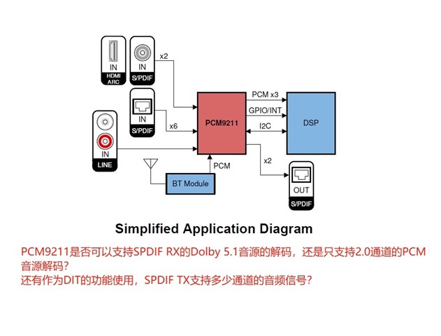

A new project is planning to use the PCM9211, and the following issues have been encountered:
1,When the PCM9211 functions as a DIR, does it support decoding of Dolby 5.1 audio sources from SPDIF RX, or does it only support decoding of 2.0-channel PCM audio sources?
2,When the PCM9211 functions as a DIT, is the following understanding correct? When the input is I2S, the SPDIF TX only outputs 2.0-channel audio. When the input is switched to SPDIF RX, the SPDIF TX will output the same audio source as the SPDIF RX (if the RX is 5.1-channel, the TX will also be 5.1-channel; if the RX is 2.0-channel, the TX will also be 2.0-channel).

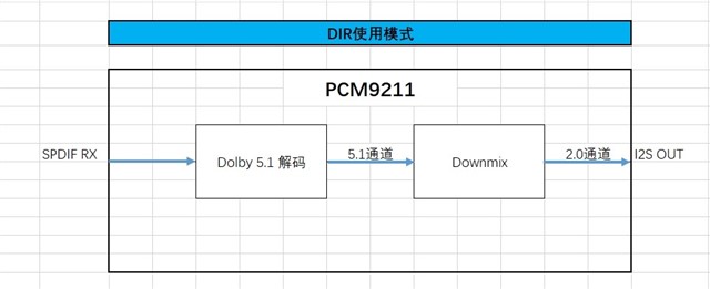

3,When the PCM9211 functions as a DIR, if it supports decoding of Dolby 5.1 audio sources from SPDIF RX, does it have the function of the "DIR usage mode" as shown in the following figure?
    PCM9211 does not support Dolby 5.1.
    I2S is a 2-channel format and thus the resulted conversion is  2 channel as well.
    and since PCM9211 does not support Dolby 5.1 nor TDM , it can not downstream to Dolby 2.0
