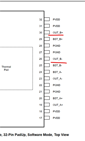

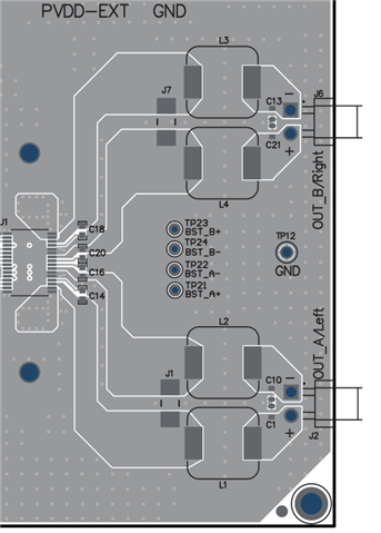

Be aware that the polarity on the Right channel (also labeled OUT_B) is labeled wrong.
Looking at the pin out of the amp and the PCB, the terminal closest to the top should have been + instead of -.
Yes you are correct. Thank you for pointing this out! We will work on updating this on our end.
