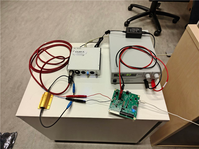

I am working with electrical amplifier measurements of TAS2563QFN implementation. I am measuring frequency response, THD, from speaker driver + - pads and play the test signal from Device's Linux system with aplay -command. However I am able to repeat this same issue on EVM with USB connection to my Windows computer.

Like I did mention, I was able to repeat this issue with EVM board and 4 ohm resistor, using .ppc3 with nothing else configured than Smart Bass as according to required parameters of our speaker driver.
In Images below, I am introducing the measurement setup I use, also results from .ppc3 attached. External Lab Power was connected to Ground / VBAT and provided 5V 2A capacity.

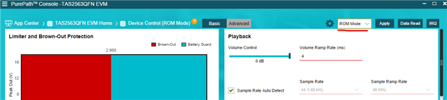

    If you test in ROM mode, this 60Hz tone will not show. You can select ROM mode in Device Control panel, top-right corner drop-list. Note that if you go back to Tuning and Audio Processing panel the device will go back to Tuning mode and the 60Hz tone will be back.

    The processing features such as speaker protection, EQ, DRC, etc are not enabled in ROM, that is correct.
    During end system integration, you still have to select either Tuning mode or ROM mode, regardless of the mode you were set before accessing End System Integration panel.

    In general, the electrical performance is tested using ROM mode, as this is the pure analog performance of the amplifier.
    Adding speaker protection and any other processing such as EQ or DRC would affect distortion measurements, as the output is no longer following the input signal.

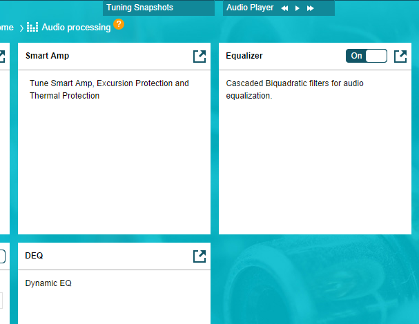

    Oh, sorry for my confusion. You are right, I mean speaker protection. I was confused by the naming of the menu "Smart Amp".

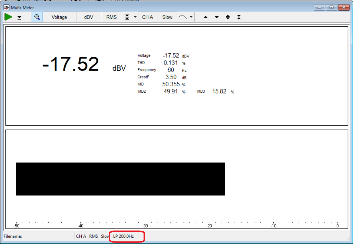

    Pilot tone amplitude of 187mV sounds interesting data, as in my sweep based measurements, it looks MUCH higher. Converted to dBV, 187mV would be -14.6dBV .

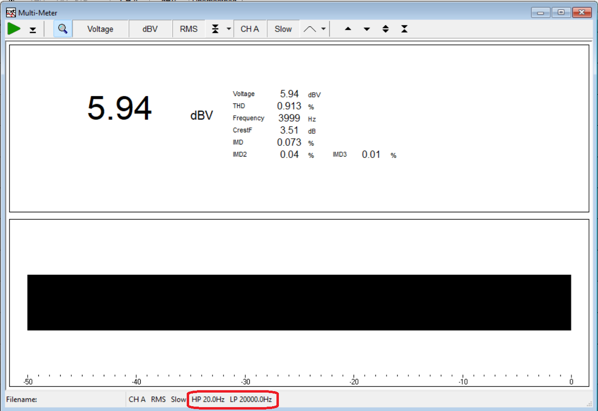

    To test this, I created new .PPC3, with default settings except under "Smart Amp" menu, I adjusted high-pass filter to 450Hz.
    As an input signal I used 4kHz Sinewave with -10dBFS and utilized TrueRMS meter function in CLIO. -10dBFS was selected as it seems to correlate to about 2Vrms in Output.
    When measuring with 200Hz lowpass -mode, I can find the pilot tone and level is very similar than what you said. I tried also applying White Noise, Multitones and MLS, measurement result was very consistent.
    I must admit that I am left a bit clueless, why Sweep or MLS based measurements show so much higher result.
