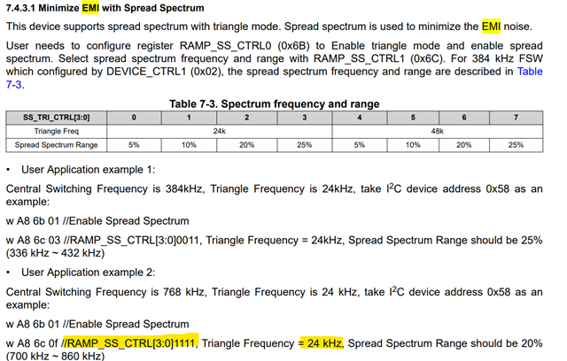

Hi Expert,
In datasheet https://www.ti.com/lit/ds/symlink/tas5815.pdf
Below RAMP_SS_CTRL1[3:0] = 0b1111, Triangle Frequency value definition is different, which one is right?
Best regards
Thomas
