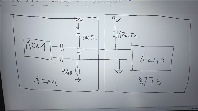

My customer asked if we have workaround for the HW below? What's the maximum Vpp for the input signal?

The customer can either allow the external 10V bias and AC couple the analog inputs between ACM and 8775
or
remove the external bias an allow PCM6240's integrated MICBIAS to serve as the mic supply. Keep the inputs DC coupled to support input fault diagnostics

Customer feedback the circuit can work well. I am curious that's why?
What's the maximum sinewave Vpp for the input signal if customer use this circuit?

The max analog input voltage are listed in the datasheet.
The input signal can swing up to 10Vrms
